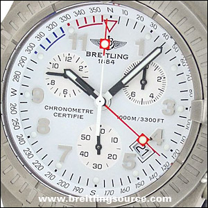

Not 100% sure but I think it could well be real. Reasons...
1. It's definitely a Chrono Avenger M1 Yachting and I've never seen/heard of a replica of this model.
2. I've never seen/heard of a Breitling replica using an ETA 251.232 movement. Sub-dials are normally wrong and there is only a big chrono seconds hand.
3. This pic of a Chrono Avenger M1 Yachting has the 5 cutting into the date aperture.
Against this, since the chrono seconds/minutes hands (assuming it's real) have both been re-set to zero, I'd expect the chrono hours and 1/10 seconds to be likewise reading zero. It's possible they have become misaligned if the seller has been playing with the pushers.
If the seller can provide a pic showing both the chrono seconds and minutes hands, that would settle the matter.

I agree that it's M1 and Sharky's picture does show the #5 to be positioned as the watch in the auction but I would still have to go with fake. The 7 lume dot is doubled IMO. The arabics are thicker at #11 and #1. Also these appear stenciled where the gen looks applied. (Did this model come with both?) The date wheel is misaligned. For the life of me I can't see two hands although it's possible they are there and very well aligned. The subdial hands look thicker and just of a gray color to me as well.
I'm still thinking definitely fake.

........although when you compare it to this pic from the site I think the arabics look better (stenciled instead of applied?)and I think the subdial hands improve as well. I still can't get over the date wheel and lume though.
The date box is not outlined on the dark dial gen on the site.
Still wrong for me.

Its difficult to call. I don't like the lume dots at 7 and 8 o'clock, but maybe Breitling quality control was having a bad day.
Here is a pic of a real one to compare:
http://www.blowers-jewellers.co.uk/imag ... /s9788.htm
The arabics, especially 1 and 11 look different, as is the 12 o'clock triangle.

I agree the 12:00 triangle looks wrong in comparison to the gens.
No date window outline on ade113's pic either. I wonder if that varied on models? Wish I had my Chronologs with me.
I'm still saying fake.
