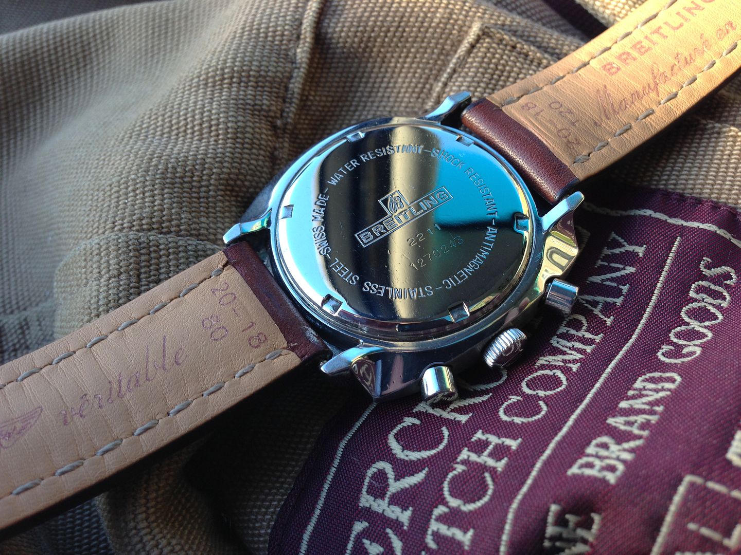

Rick, the watch is authentic, assume the caseback was massively scratched and refinished, seller had the engraving "restored" - huge effort, but ......
edit, as Roff posted while I was writing - quite clearly re-engraved, would walk too.
This is how the caseback engraving should look: :lingsrock:
