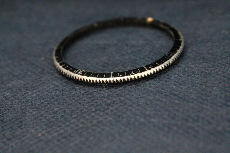

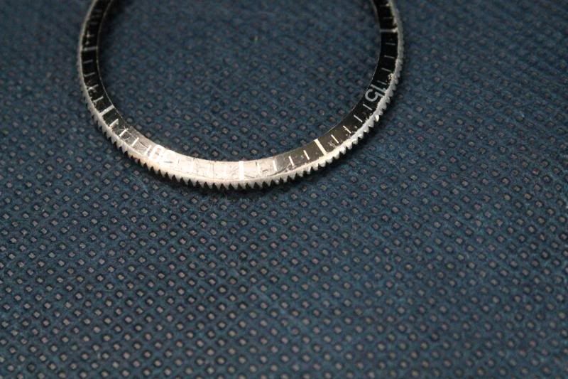

I take your word for it but I disagree , your bezel is mint/NOS . Not a flake of paint is missing around the edges
If it were used as a dive or yachting watch the bezel would have looked something like this
there's no way that you do not hit anything on a yacht with your watch, standing rigging , sails , lines, anchor chain etc (ask me how I know :-( ) or while diving . The case of your SO2005 has proper use marks , scuffs and scratches, its a stainless case but the soft aluminium bezel is flawless ?
But again, please provide documentation and/or provenance that these SO 2005's were supplied with yachting bezels and I will gladly publicly state I am incorrect in my assessment and your watch is 100% genuine as is with yachting bezel
