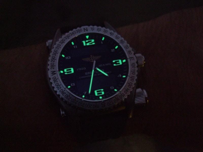

This might be a stupid question. But I have original yellow face Emergency E56121 model. Do they suppose to glow in the dark?

Thanks for helping. Currently mine are not glowing in the dark.
Do they have to be exposed to sun first in order for them to glow? should I leave them for few hours on my balcony to soak up the sun rays? Does it have to be sun or can it be light bulb?

You have a yellow dial Emergency. Therefore the black numerals do not have any lume, only
small "dots" behind each number.
The blue, black/grey and coral dial Emergencies all have lumed numerals, and glow very well indeed.
