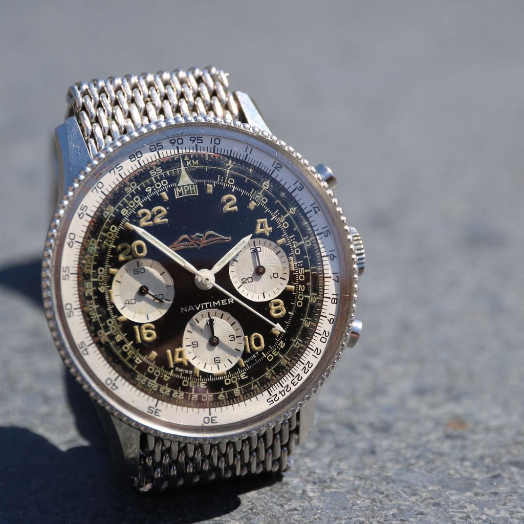

here's a 809 with 'beads of rice' bezel , funny as I just took the pic 15 minutes ago ;)
PostPosted: Tue Jun 30, 2015 3:13 am
transitional, David, we see both.
unfair "competition", Rene
