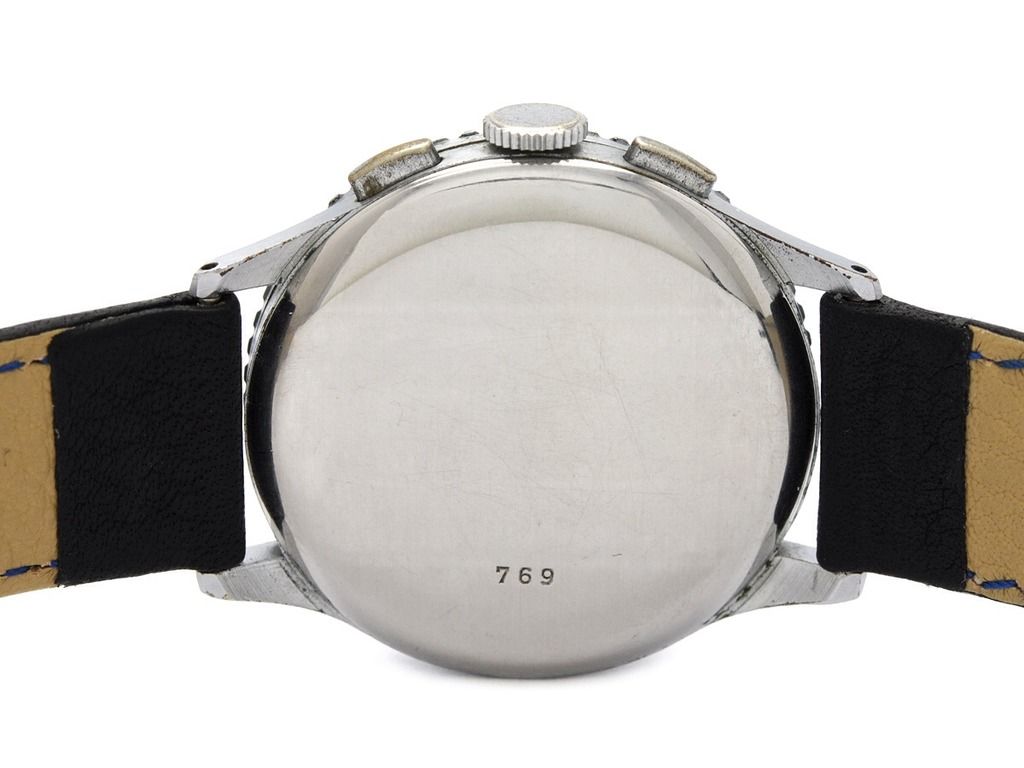

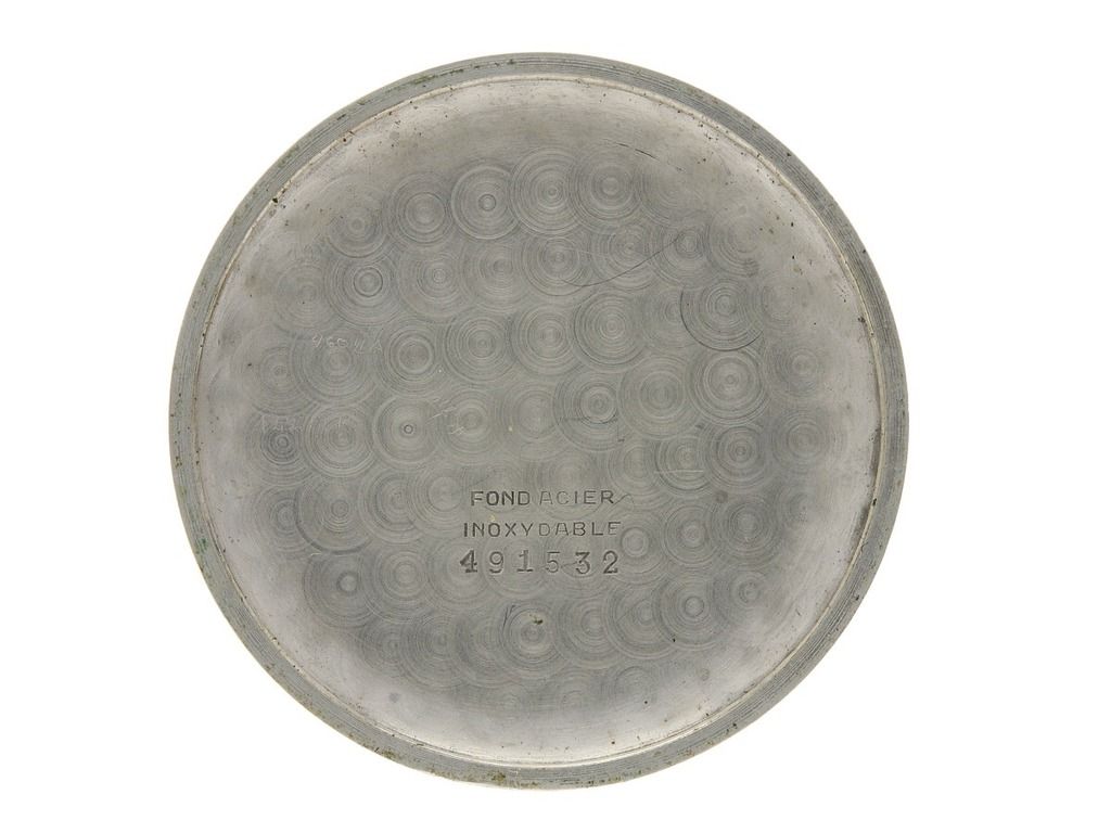

Just picked this up at Kaplans auction. Wondering how much of it is genuine?
The bezel does not turn so assuming that not original. Also wondering if sweep hand not original?
Not much lume left in hands. God knows what else?
http://i1082.photobucket.com/albums/j36 ... 8unys4.jpg
http://i1082.photobuckethttp://i1082.ph ... oumzr5.jpg
http://i1082.photobucket.com/albums/j36 ... qt1ye7.jpg
http://i1082.photobucket.com/albums/j36 ... hwr1o6.jpg
Thanks for any input.

Also, I note the minute register does not have the extended hash marks at 3,6 and 9 minutes.
Does that mean dial fake also? Do I really want to ask these questions? :)
PostPosted: Wed May 20, 2015 12:39 pm
all seems correct and original, an early chrome plated piece. in excellent condition.
was bidding on it ;)
bezel is cirrect too, no fake bezel I'm aware of, just needs a competent watchmaker and it will turn again.

Thanks Fred, but does it bother you ( or better said, should it bother me) that minute dial does not have the extra long hash marks for 3,6 and 9 minutes??

David, the bezel is without doubt correct, the first versions were mounted w/ miniscule screws - and these tend to "freeze" the bezel in place. needs a bit of TLC, that's all.
the earliest dials had no elongated 3/6/9 markers, there also was a "rail" subdial version.
this is a VERY early piece, so no worries here.
crystal needs replacement though, huge issue at about $10

I'll dig up a pic of my early rail subdial non-marker piece in a bit, but this very catalog might help too ?
note markers at 3/6/9 on the ref. 782, none on the 769
replace the crystal, repair the bezel, leave all the rest.
