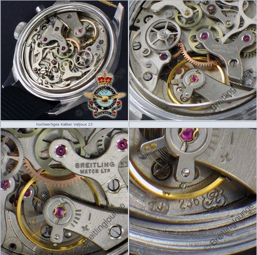

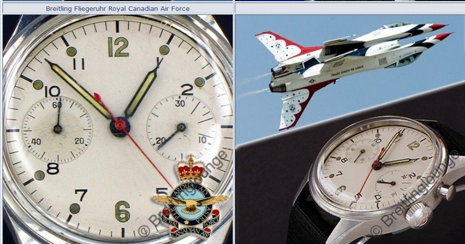

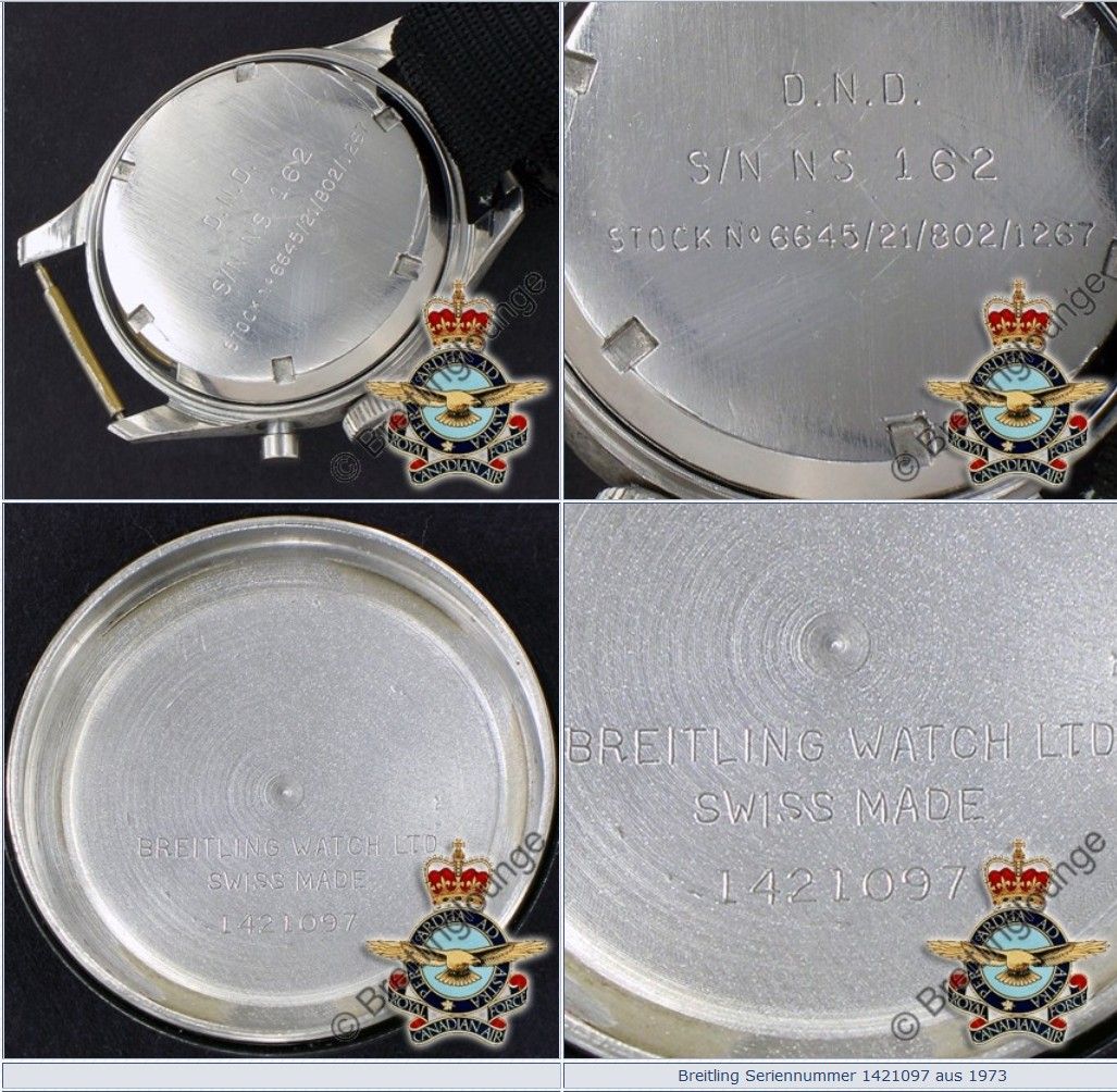

Hi Guys,
I´ve bought an RCAF Breitling and I´ve seen several on this board. I´d like you to have an honest look at it and say what you think, franken or real, as I have a fellow who won´t back down from his earlier obsevations. First he said it was a Fake,
Quote:
that this particular watch & stock # (6645/21/802/1267) was manufactured for the Canadian forces by Breitling ?
Quote:
you also refer to the #21 on the back, saying that that is for Canada , but the 1968 model (1805/67) was made for Germany according to that other website ?
Quote:
Now I am not a MIL watch expert , and I dont even proclaim to be a Vintage Breitling expert either but over the years I have held many (50+) Vintage Breitling watches and can point out the difference between factory original and 'not quite right'. For me your watch falls in the 2nd category , I think someone did a pretty good but uninformed job making up a watch using the available info on the internet without understanding what the engravings mean ?
Quote:
As always Buy the seller of the watch and keep in mind the provenance of a watch. So unless there's a paper trail to be followed about this particular watch or it was sold by the very person that received the watch as a RCAF serviceman I am entitled to my opinion . And in this case my opinion is that this watch did not leave the Breitling factory like this.
In other words its a FAKE / FRANKENWATCH
After much convincing and links provided to NSN numbering, he slacked off that accusation, then in his eyes the engravings are wrong...etc.etc.
What do you guys say?
The first 4 pictures were suplied by the seller, watch polished (half to death) and very well lit.
The darker ones I done today!
The dial is scrached between 12:00 and 2:00, and a scratch at 11:00 (but hardly to be seen under normal lighting!)
Thanks for your time guys.

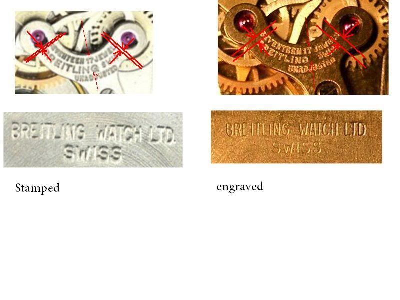

So thanks for posting it here as well so I can explain my objections to this particular watch. I wont go into the Michael M fake unless someone wants to :D
For the record, I didnt 'back down' on WUS , I was simply done with my assessment of the watch that the topic starter showed us but as the same questions are asked here I will answer them here again as well
One interesting comment that the Topic Starter(TS) made is "The first 4 pictures were suplied by the seller, watch polished (half to death) and very well lit."
Ask yourself, if the watch case is polished half to death , there must have been a lot of usage of the watch , which I would expect from a military watch. So why is the case back, caseback engraving as new and looks like it was recently done ? , I believe because its a recent job. Same for the dial and movement

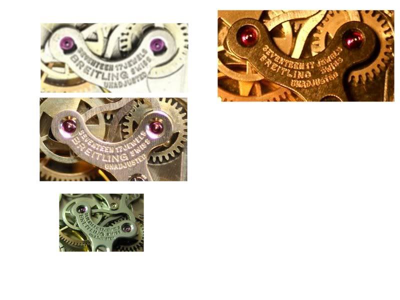

so my objections to this watch are :
Breitling has been stamping movement bridges at least since the mid 50ies. Why is the bridge of this watch engraved ?, this is inconsistent with the period AND with other Military Breitling watches that float around on the web
As you can see the left bridged are clearly stamped with Seventeen 17 jewels Breitling swiss unadjusted. Just like one would expect . However the TS watch is engraved and inconsistent. the "S" and "B" do not have the same starting point the 17 is not over the G as in the others and the W from swiss dropped and is misformed .
And if you look at the bridge where the jewels are fitted, do you notice how the holes where the jewels sit are straight , and not angled like an original Breitling stamped bridge ? again an inconsistency
Also the inside of the caseback is clearly engraved, and NOT stamped as the other watches are , so 2 engravings which are both coincidentally Breitling marks ?
so this, together with the brandnew engraving on the back which is inconsistent with a polished to deatch damaged military watch still leads me to conclude that this is a fake / franken watch unless someone else shows me a watch from the same era with the same 'inconsistencies' that is a proven original (and I dont mean the Michael M fake ! as I can tear that one apart as well as being fake on several points)

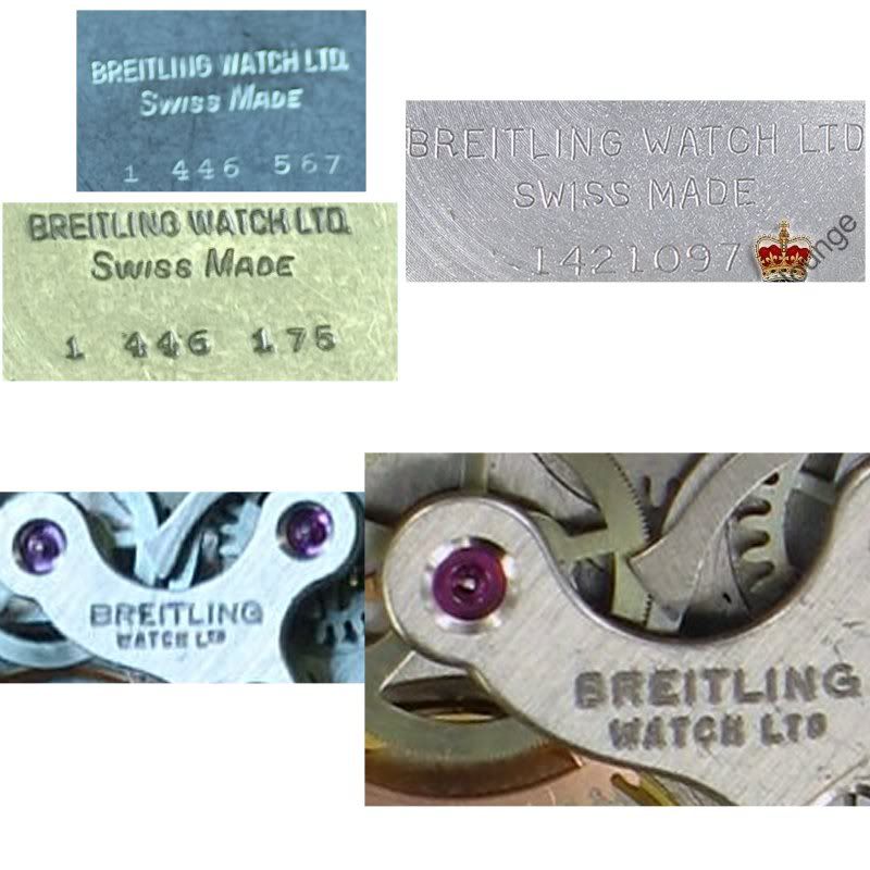

here's why I believe the Michael Marz watch is also a fabrication.
Good watches on the left , the fake on the right
again, "Breitling Watch LTD." "Swiss Made" and serial numbers stamped , not engraved.
Also note that watches are from the same era and there should NOT be a reason why Breitling suddenly started to do (very bad !) engravings
and the serial number always follow a pattern of 1 234 456 , with spaces between the number groupings , the fake one has the serial all lumped together without spacing
the bridge , please note that on the left we have a Breitling bridge marking that we are all familiar with , the one of the right however is (again) an engraving , "B" is most notably different between the 2 but the whole font is incorrect and if you look closely the "T" in LTD is almost as long as the "L" where in original stampings the L is capped with the td smaller and aligned with the top of the L and the d isnt even looking like a d at all

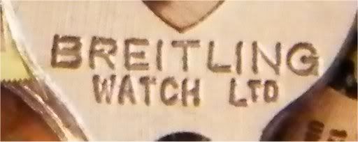

p.s.
here you can see better what I mean with the Ltd. (from a V178 movement, same script though)

just noticed one of my own remarks and it add to the proof that the TS watch is fake
ALL military breitling I have been able to find follow the 1 234 567 format for the serial numbers , except the 1 from the TS and the one from Michael Marz , which have serials lumped together without spaces
here's the 'known' list so far , they even went as far as to add the spaces in the list as well , and the pics above support my claim , but as always I am willing to state my error if overwhelming proof is presented :D
http://www.flying-time.de/wbb2/thread.p ... light=rcaf
1 073 822 (1966) - 1256/67 - hondikee.com
1 073 828 (1966) - ? - Knirim Buch
1 073 97? (1966) - 1358/67 - Canada
? (196?) - 1514/67 - Canada
1 074 069 (1966) - 1227/67 - Germany
1 074 332 (1966) - 60/67 - Canada
1 123 076 (1967) - 2103/67
1 123 157 (1968) - 1805/67 - Germany
1 294 942 (1969) - 2303 - Canada
1 XXX XXX (1969) - 2305 - USA
1 421 097 (1973) - 162 - Canada
1 421 398 (1974) - 317 - Austria*
1 446 125 (1977) - 1086 - Canada
1 446 331 (1977) - 978 - USA
1 446 427 (1977) - 691 - Germany
1 446 567 (1977) - 869
