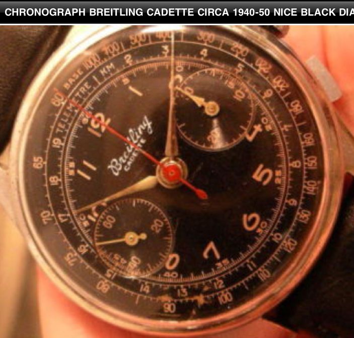

Hello,
Read several posts on the forum after buying the watch below and that made me so to say less enthousiast about my last aquisition. A year ago I bought via ebay my first vintage watch (Seiko 6309) and all went very well. I saved up during the last months and decided to go for my second vintage and 'hunt' for a vintage breitling, after a few weeks of bidding pleasure and not winning the item. Last weekend I finally won.... Well after reading through the forum that might be not surprising......
Below you see the watch I won. The desciption was:
VERY NICE CHRONOGRAPH BREITLING DATE VALJOUX 7734 insigned MOVEMENT CIRCA 1970 SIZE 38MM42,8MM CHROME CASE STEEL BACK (GLASS NEEDS TO CHANGE it presents a damage).
There is not signed the bringe movement but this caliber is used frequently for breitlling in this period Original Dial Breitlilng with date in excellent condition no damage. Nice working condition but we do not assure its accuracy.
Upfront I read the feedback on the seller and all was positive and already sold 10's of other vintage watches. However after reading through to forum I discovered thee were also 'Franken' Breitlings... Well... Now I think I acquired one of these. Below a nr of pictures from the seller.
What do you think of it? Fake, franken or.....
Thanks for the feedback
PostPosted: Thu Dec 22, 2011 11:51 am
sorry, but you knew the answer, fake, total fabrication.
had this on my vintagejunk watchlist some days ago I think, as this was a recent purchase, contact the seller, I am sure he will agree to take it back and refund, if not, you could open a paypal case, will take a bit longer, but you'll win that.
PostPosted: Thu Dec 22, 2011 11:53 am
I'm sorry, but I think that this is an outright fake.
For the era that this is claiming to be the dial should be block letters rather than script, the bridge should be signed and there should be model and serial numbers on the caseback. While there is a serial number it is inconsistent with any real Breitling of this period.
Sorry that it's not better news.

Thanks for the quick feedback. Well I hoped at least for a franken.....

found it http://www.ebay.com/itm/CHRONOGRAPH-BRE ... _980wt_999
again, my advice is to contact the seller, inform him the watch is clearly fake.
Wrong logo for claimed period
No documented Breitling model
No model reference
No correct serial number
Am sure seller will cave in, if not, open a paypal case assuming you used paypal.

This was once a nice watch. On an ancillary note, the quality of the script "Breitling" on the dial is scary good, which is why I suspect it's also being added to some older and worn dials, too.
frighteningly so. seems to be a master faker in Spain, look at this:
http://www.ebay.com/itm/270875678657?ru ... _910wt_999
could be the same seller, text passages in the listing are very similar.
am sure he will be more than happy to refund, just to make sure his feedback is unhurt, selling quite a lot.
