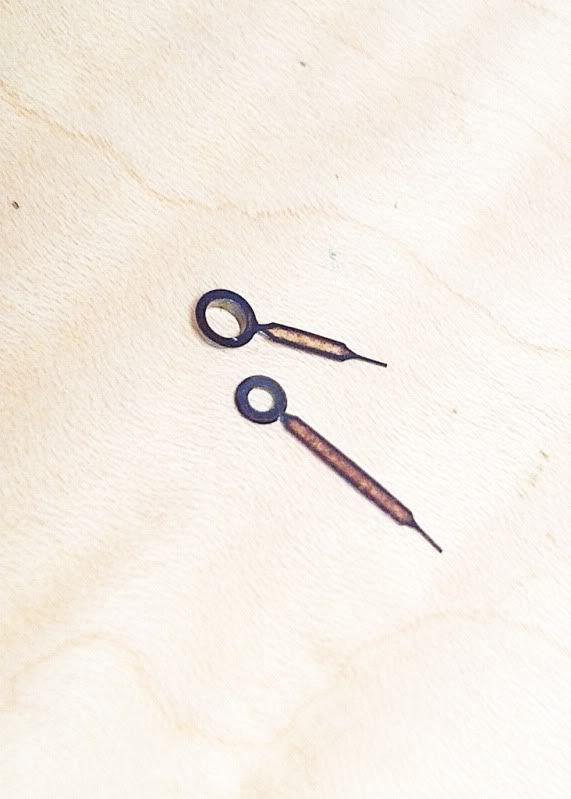

Definitely replacements - they are way too short apart from anything else so from a smaller watch.

Ok. Think I got the correct hour & minute hands.

Edging a bit closer. Found out today my other hands are too big. :( Have to figure out the proper measurement to search for. Looks like 1.4 & 1mm hole is what I measured, but that's not the right way to search hands. I've got to dig a couple more sets out to see what we've got. Also have to reset the stem and crown to the right setting.

Hi,
On the table below I have compiled the right hands diameters for different calibers , in 1/1000 mm. You can see that Venus 175 hands have the same diameters than Valjoux 7733 to 7736
Calibre Heure Minute Sec.au centre Compteurs Petite sec.
Valjoux72 - et 23 160 109 25 25 23
Venus175-178 140 à 145 95 27 à 30 27 à 30 18 à 20
V7733-34-36 140 à 145 95 27 à 30 27 à 30 18 à 20
V7740 180 100 24 à 27 24 à 27 24 à 27
V7750 200 120 25 cône3° 18 cône3° 18 cône3°
V7765 200 120 25 cône3° 18 cône3°
ETA 2892 150 90 25 à 26 25 à 26
Lemania 1873-Omega 861
Cal 11-12-14-15 180 100 24 à 27 24 à 27
EB8420 180 130 18 18
UG 264 120 65 25 25
UG 285-287 170-180 100 28 28 Lune et date 74
Universal 281-481 160-170 100 25 25 Lune et date 72

Thank you for the great list!! Now saved in my archives.
I also read somewhere that Landeron 48 hands were the same size(or at least fit) as the V175. Can anyone confirm this? Guess I could trial & error on my spare movement, but my shaky fingers have me worried.

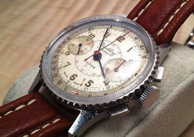

Thought I'd share a little update.
Finally got the bezel number rings done and picked up today. It took a few trial and error attempts to get the OD/ID just right. Seems there are slight differences in tolerance in the bezels. The first pieces cut turned out .004 to small, and they would not hold in the bezel. Also at .020 thickness, they were too big to allow the bezel to set properly to the case.
We went down to .015 thickness and switched to steel for durability. We tuned in the OD and viola. Here's what the bare ring looks like sitting around the dial. I didn't snap it fully in the bezel as it would be hard to remove without damaging it.
I'll send a couple off to get painted tomorrow. Should take a week or two to get them back. Fingers crossed that Intl. Dial can pull these off.

Played around with a couple more rings today; cleaning off burrs and making them paint ready. Just had to put one in the bezel to make sure all was fitting just right.
(insert happy dance smiley here)
