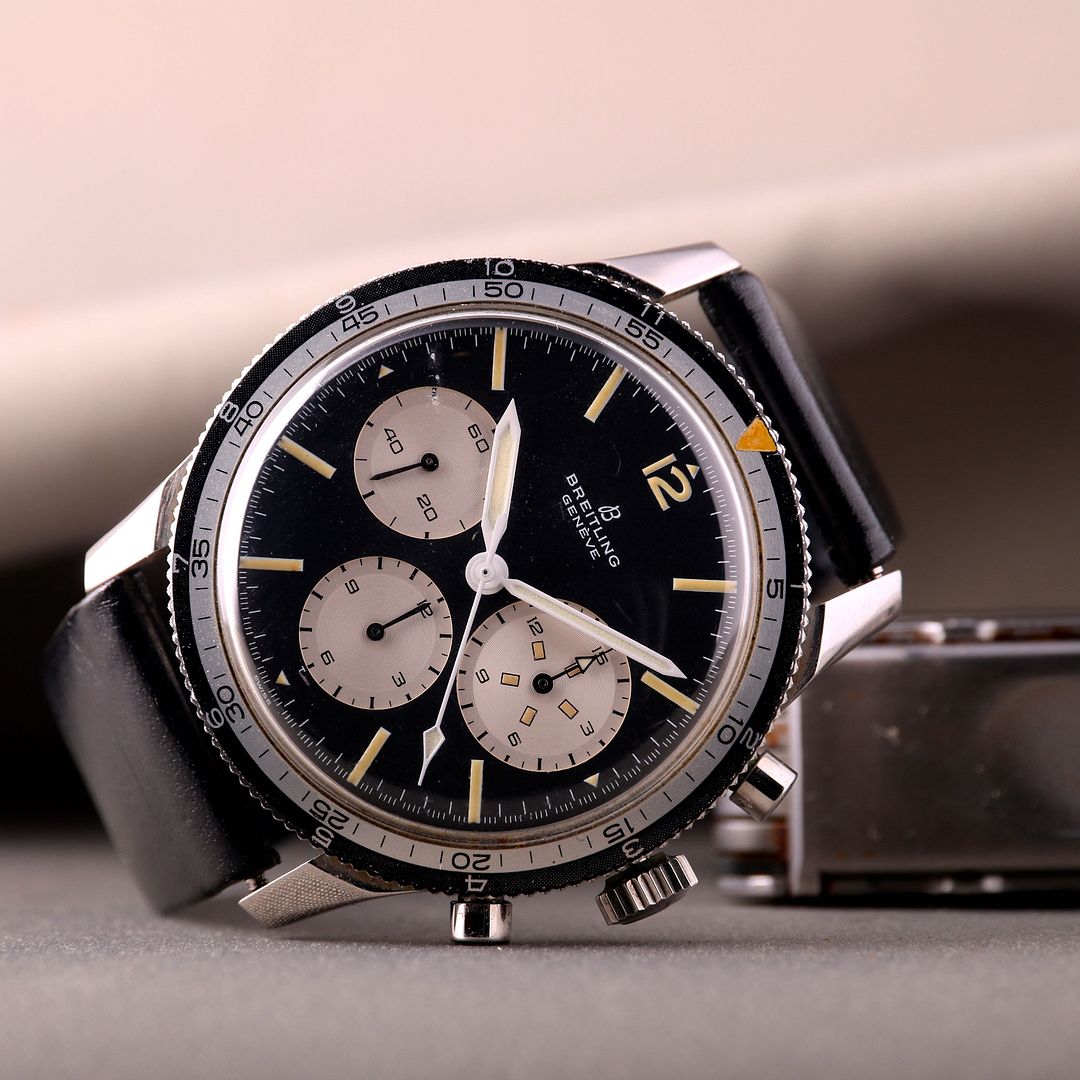

panda is a lost cause; lume is dead.
the all black COULD be saved; a gamble, but well worth a try.

as this thread is read by many and I've posted the reference pics on TZ; let me post the correct dial variations for this case and hands u have:
digital 765 AVI, execution three hands:
analog 765 AVI "allblack":
panda configurations have a different bezel (and date range), as discussed; analog 765 AVI "reverse panda"
an option to consider MIGHT be to try and relume your panda dial, but it will be visible; especially as there is no realistic way to clean the subdials.
you could look at Breitling's reverse pandaa service dials, these are better (i.e. closer to the original design) allblacks.
Fred,
I forgot to ask - Do you happen to have a picture of the Breitling service dial for the Panda?
Thanks!
PostPosted: Mon Jun 27, 2016 12:40 am
Fred,
Thanks!
please ignore the bezel, those are available in black, stainless steel, and this version

Rene - Nice shot! As Fred said, those look much nicer and closer to the original.
