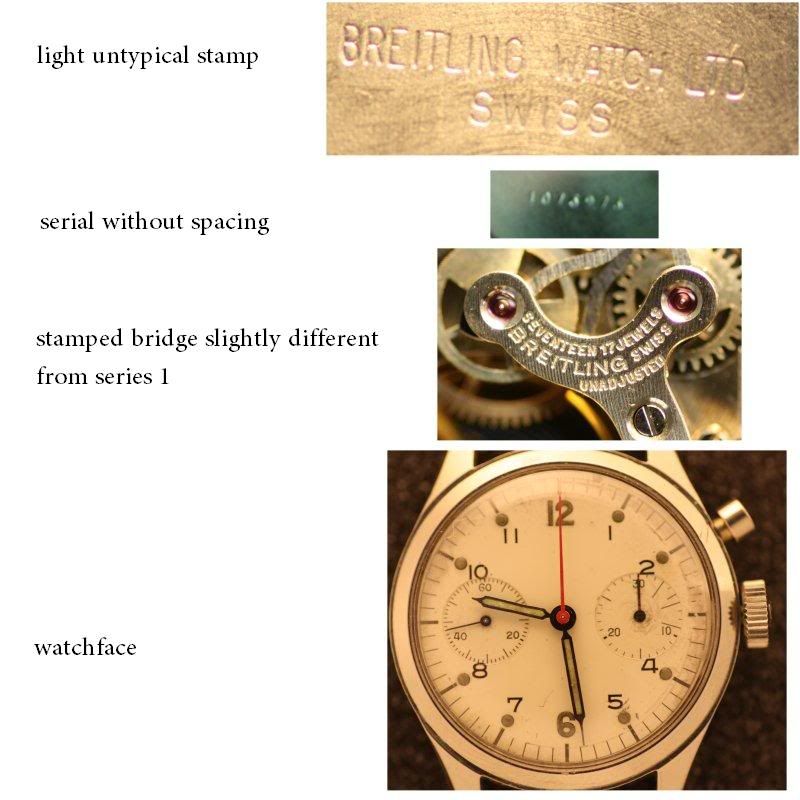

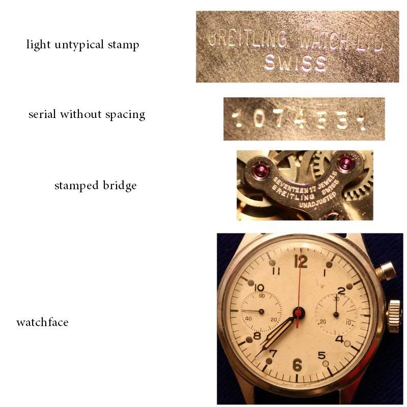

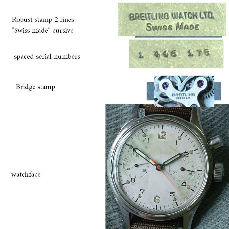

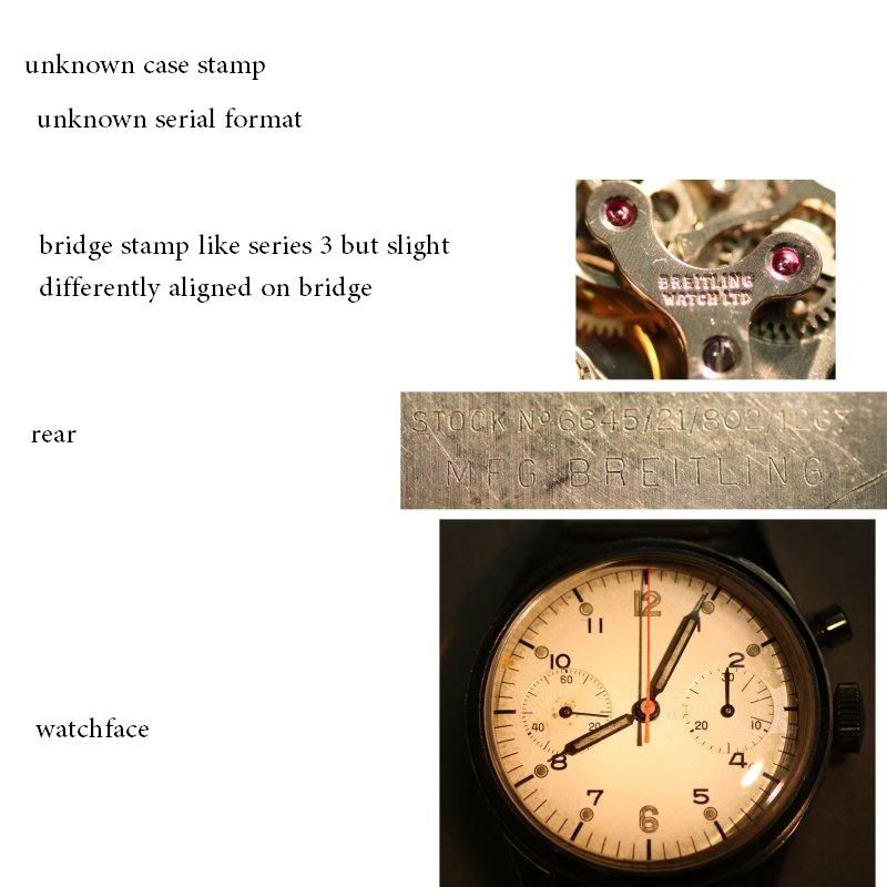

So first things first
There's still something 'iffy' about the bridge marking on the Mr Bo watch , I don't know what it is but it might be down to the camera used , the lighting or a combination of the 2 but when doing a 1 to 1 comparison there's still differences. A better close up pic might take away all doubt ?
And I will graciously admit that Bo's watch (unlike Michael Maerz's fabrication) fall's into a category I think are authentic (congrats Bo)
What I have done over the last hours is compare several watches from several era's / series , and found that there are 4 distinct 'series' with each their own typical specs and characteristics (spelling?). I dont even know if we should post it here as we're giving away the details fakers need to produce better fakes as these are getting more and more expensive , 5000 GBP for a Omega , USD $60K for a Rolex military , so its only a matter of time before fakers discover Breitling doesnt have any records anymore so they can start producing more and more fakes.
anyways , here's series 1 through 4 and there might be others
PostPosted: Thu Jan 05, 2012 7:01 am
Rene, you are a true gentleman!
I wonder whether the bridge marking may be as simple as a manually operated stamping machine? The spacing seems to match so could it be the actual process of making the stamp that differed?
In terms of posting info at the risk of helping fakers, I think that it's a risk that we have to live with because it is only through posts like this that the overall knowledge of Breitling increases.
PostPosted: Thu Jan 05, 2012 7:08 am
I believe its a different series of bridges stamped as the last bridge the LTD letters are all the same size , the first stamp L is big and TD are about half the size of the L
so its not just the spacing and alignment but also font size
