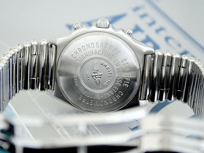

Today I received a Breitling watch. Unfortunately I have no idea what model, year or whatever. On the front it says, 'Breitling Cronomat Automatic'. On the back it is marked, 'Chronograph' and the serial number is A13350.
Any idea??

Thats the model number, not serial number
End of Discussion.
PostPosted: Mon Mar 26, 2012 10:44 pm
to be a little more helpful here, a13350 is a model number shared by several variations
of the Chronomat line, not an expert on these, but it seems to be a Chronomat GT
on a Rolleaux bracelet, part of the Windrider series, manufactured between 1997 and 2000.

Fred is correct. The model name is the Chronomat GT and was part of the Chronoliner range (later re-named Windrider). The model reference is A13350 which encompasses all Chronomats including the GT and Vitesse. You may be able to see the serial number just under the model ref although it may have worn away over the years.
The Chronomat GT appeared in the (catalogues) Chronolog 2 (1998), Chronolog 3 (1999) and Chronolog 2000. Price, at launch, was US$3,875.

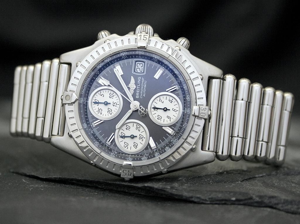

Hi, Gina. Here is a 2000 vintage Chronomat GT. The reason the middle digit in the model number is a "3" vice the "0" on your watch is because that was the year Breitling started COSC certification of their entire model line. Other than the change to the model number, the watch is identical to yours. I can't tell from the pic if your watch is a black dial but in any event, this one is the slate grey dial with silver subdials.
Congratulations on the acquisition of an iconic and beautiful timepiece. Please wear it in good health! :lingsrock:

Great info, thanks. I did find the serial # under the ref #. It's identical to the one Ron posted.

Sorry 'bout that'. :oops: What I meant was my new watch looks identical to the picture that was posted by Ron.

Slate grey dial also? :D If it is grey Either way, grey or black dial, it is a wonderful timepiece which should give you years of enjoyment. BTW, If you'll "search" the famous auction site every now and then using "Breitling manual" for your keywords you will find quite a few different model Breitling manuals. You'll be looking for the one which reads "Chronomat" on the cover. They do show up every so often so keep looking. Fortunately, Roff gave you all the instructions you actually need for the watch and besides, the manual is somewhat disappointing because there is not much more information available in it anyway. I'll try to find one for you also and let you know if I do. Sorry to tell you I had an extra one which I gave away last year to a fellow who was missing one. :roll:
Congratulations again and enjoy your new Breitling!
Best,
Ron
Edit: I just blew your picture up and read the label which indicates the dial is "blue" and that year 2000 blue is very handsome indeed!. BTW, list price of that watch in 2000 on the model 101A "rouleaux" (bullet) bracelet was $3,325 USD. The watch head alone was $2,725, "Rouleaux" bracelets were $600, "Pilot" bracelet was $950, leather strap was $100, croco strap was $300, deployant clasp was $200. Equivalent list prices today are almost or more than double in some cases. I sold that grey GT 2 years ago for around $2700 IIRC which was IMO a great bargain for the buyer. :)

Hi, Gina. Here is a 2000 vintage Chronomat GT. The reason the middle digit in the model number is a "3" vice the "0" on your watch is because that was the year Breitling started COSC certification of their entire model line. Other than the change to the model number, the watch is identical to yours...
Oops. :!: My bad. :oops: I misread the original post. Gina's model number is identical to mine which of course means Gina's watch is COSC certified and is indeed a 2000 vintage piece. 2000 was the last year of Chronomat "GT" (sunken numeralized subdials) production and the only year a "GT" would have the second "3" (for COSC certification) in the model number. The "GT" was dropped for the remaining years (2001-2004) of standard Chronomat production and of course the subdial design had been changed to a different style. (not as attractive IMHO) Gina's watch is a "one year wonder" and she is quite fortunate to have come across and acquired this elusive piece. :lingsrock:
