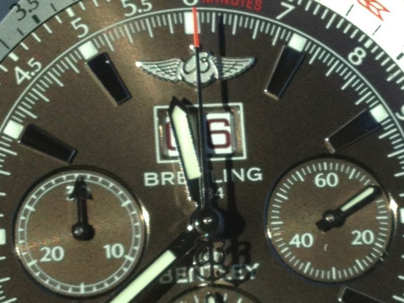

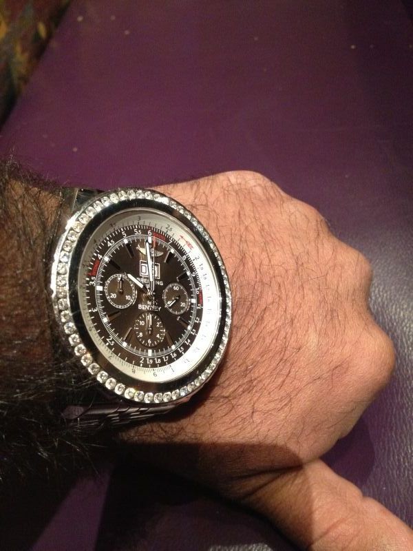

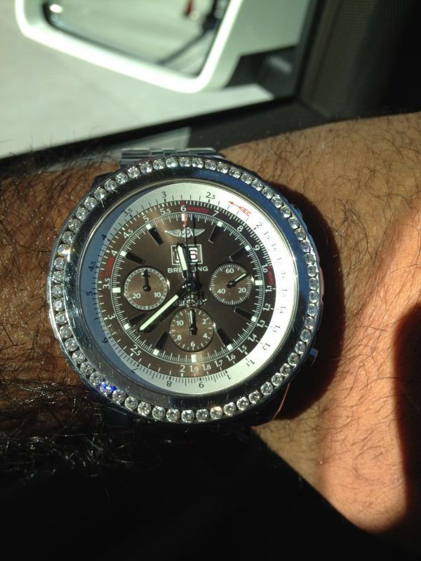

Here's the pics and no doubt whatsoever in my mind that it's genuine. I've done a crop showing the date window to save you zooming in :wink:
So, anyone got any ideas why it might be stopping?
