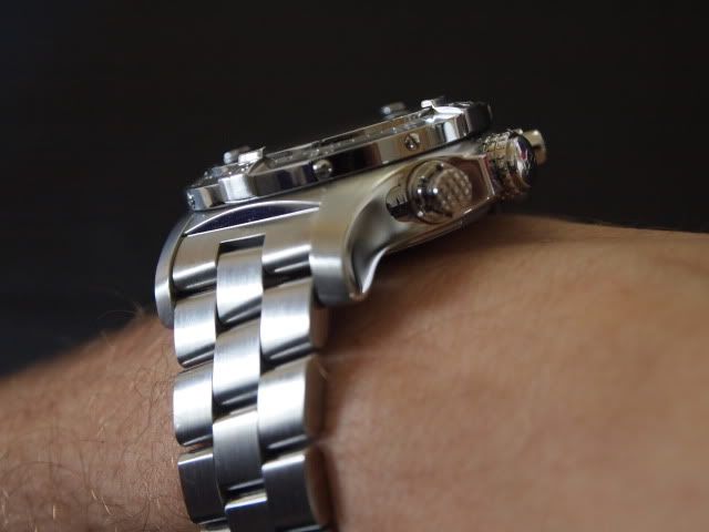

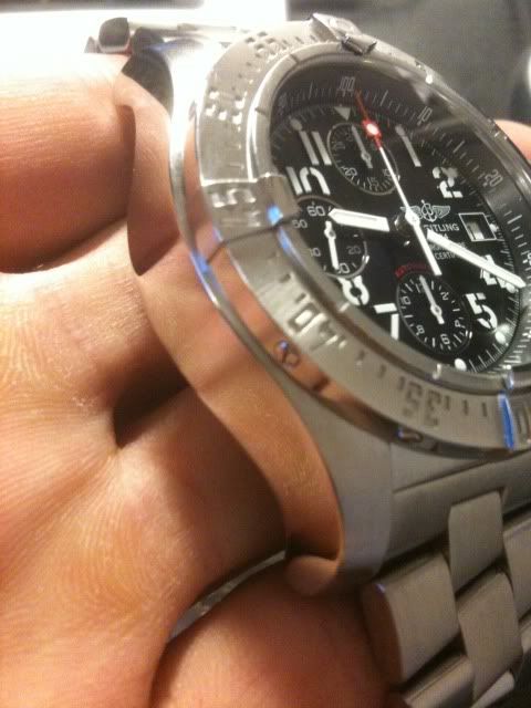

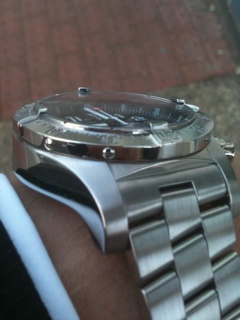

So... iv been playing around with the buffing machine and ultrasonic cleaner again! but with a slightly better outcome. I decided not to put the watch into the cleaner but give my skyland a brushed satin finish:
Sorry about the crappy photos, i had to use my phone. Im not finished yet as i need to do the back. i wanted to go along the seawolf look and leave the sides polished and use vertical lines on the case. Ive ALWAYS wanted to do this and all in all im very happy!

Looks good! I much prefer the brushed finish.

Oh god...not the ultra sonic cleaner AGAIN???????? Haven't you learned from the first disaster? :poke: LOL
It actually looks pretty good though...nice work. I always though the Avenger would look much better with a brushed finish.

Brushed looks great on that piece, wish Breitling would brush more of their models!

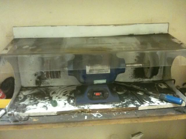

Oh, cool. So, what's the whole procedure for the whole shebang?
remove the bezel
tape the areas you don't want polished.
buff away.
remove tape
attach bezel
done?
What did you use to brush it up? Any technique pointers?
Did you brush the bracelet to match, or is there a brushed bracelet that already matches?

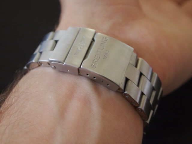

yeah prety much. it went:
1) remove bezel
2) remove bracelet
3) tape the areas (including the sides of the bracelet), be anal with it.
4) buff the bracelet then put it in the ultrasonic cleaner with the bezlel (ahhhhhh old freind!)
5) buff the case (DO NOT PUT IN ULTRASONIC CLEANER)
6) clean all of it with a tooth brush and washing up liquid
7) i then used a abrasive stick (basicly a stick with wet and dry paper on it) to lightley brush the little bits that the buffing wheel couldent get to.
8 ) put it all back together!
and i used this to brush it up:
Not exacly evreyone has on of theys lying around but thankfully my work has one!!

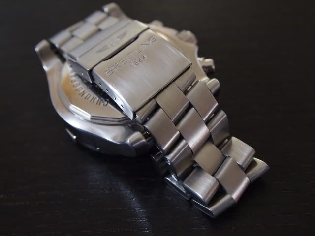

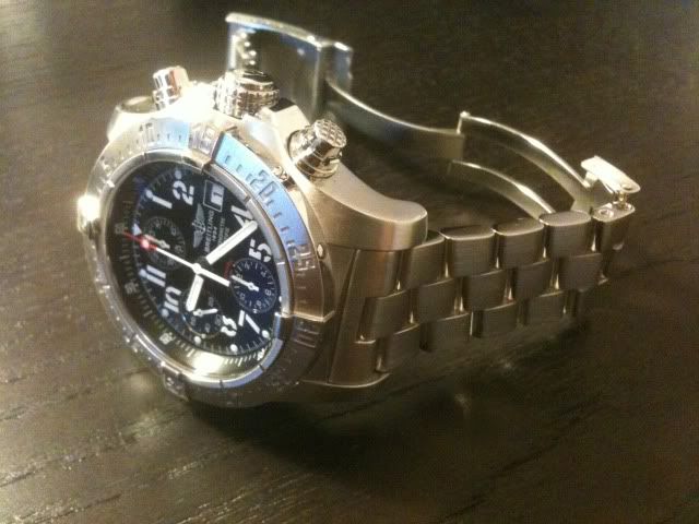

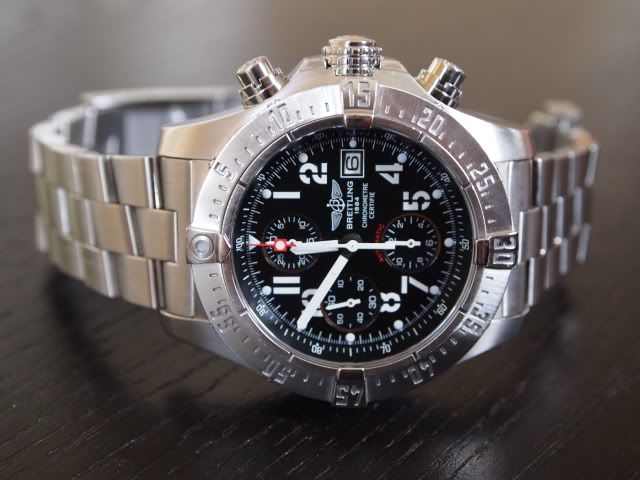

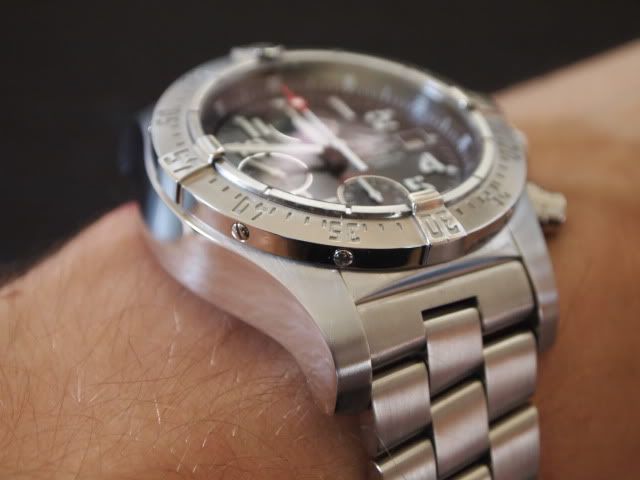

Im going to finish it off today (the back of the case still needs doing) i will do some nice shots on wednesday :D
 Post subject: Re: Been at it again...
PostPosted: Wed Jul 06, 2011 3:33 am
Posts: 694
Location: uk

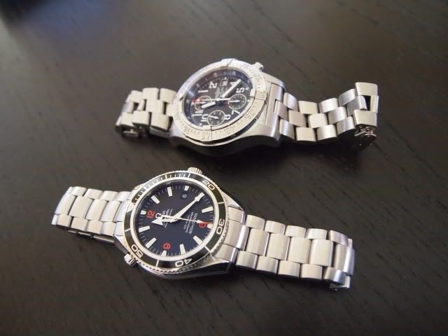

As requested :lingsrock:
the Omega is for sale btw!
