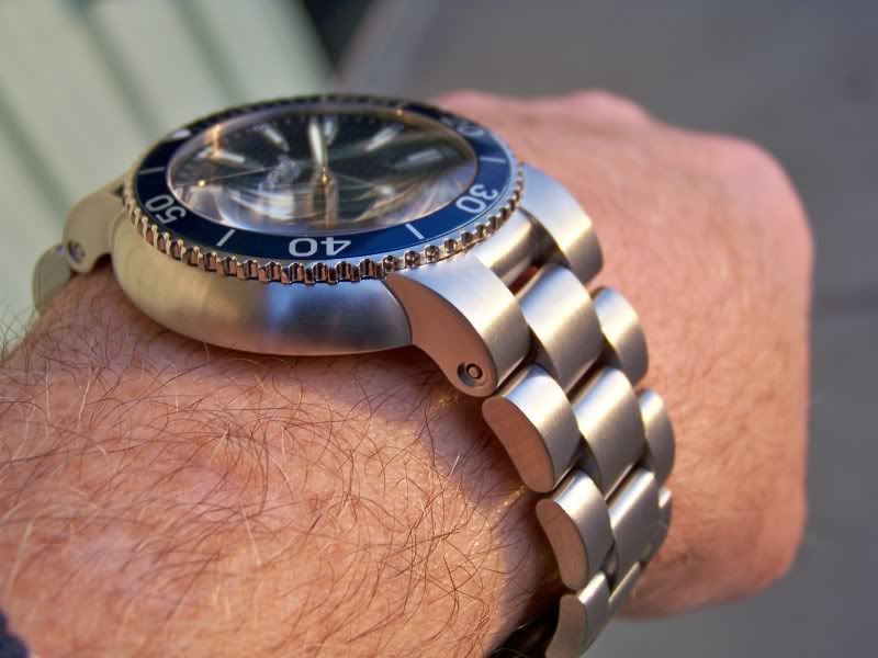

If you set a scotch- brite pad on a flat service and run the bracelet over it in a straight line all your brush marks will be going in the same direction! Always make sure you go the same direction across the pad and do the same with the case and you want have a bunch of brush marks going in every direction. If you want to keep some of it polished just cover it with masking tape!!Here is picture of an Oris that i brushed...
TREVOR
PostPosted: Wed Oct 07, 2009 5:28 pm
Joined: Mon Aug 31, 2009 3:13 pm
Posts: 139
Location: Vancouver, BC
Yours looks GREAT! I'm going to try and "straighten" mine out!

[quote="cali kid"] Always make sure you go the same direction across the pad and do the same with the case and you want have a bunch of brush marks going in every direction.
:yeahthat
I'm afraid the job done on the SA is no good - the brushing needs to be in the same direction! The SA looks like a kid's colouring in with a texta...it goes every which way.
For a watch that costs so much you really should get a pro to do it.
