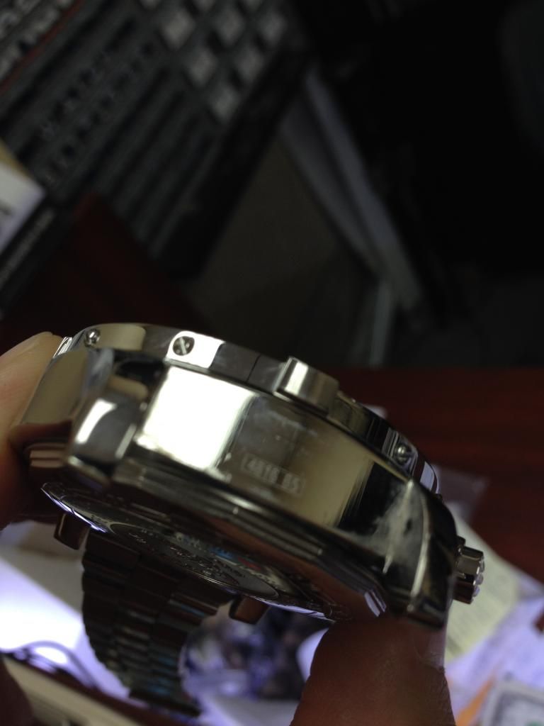

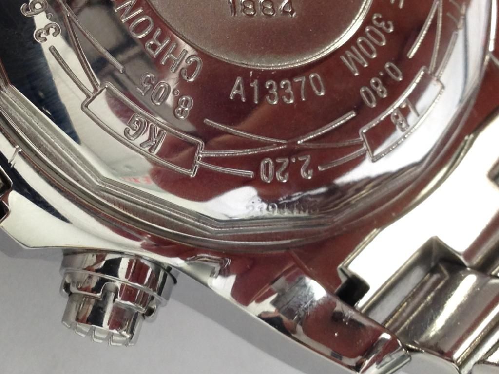

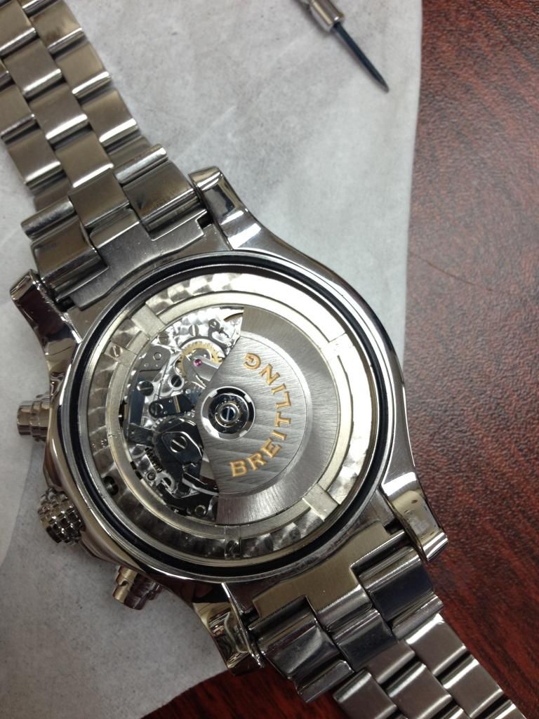

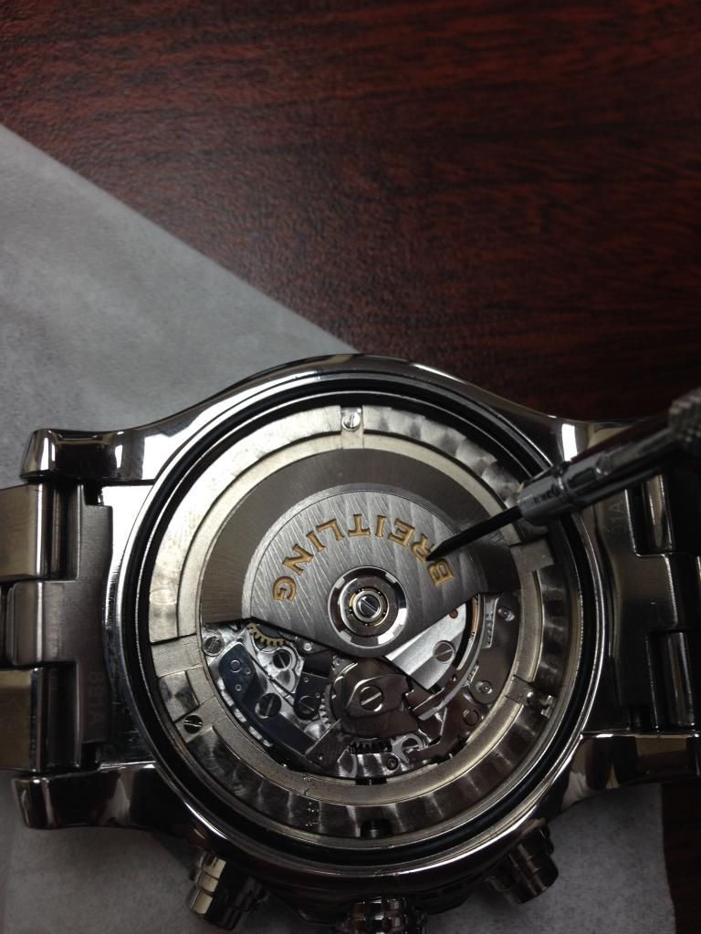

Can someone help me verify if this is fake or not. Its a super avenger the one with the bigger logo, paperwork says from 09, but the date code on the watch doesnt make sense as the first four number are 4816.

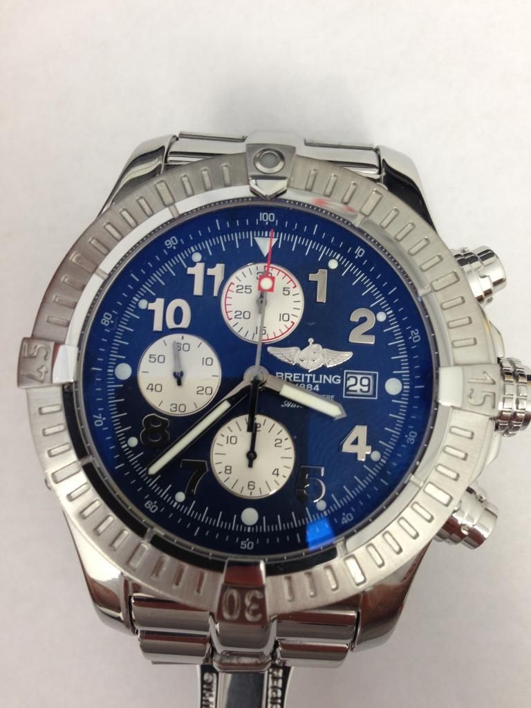

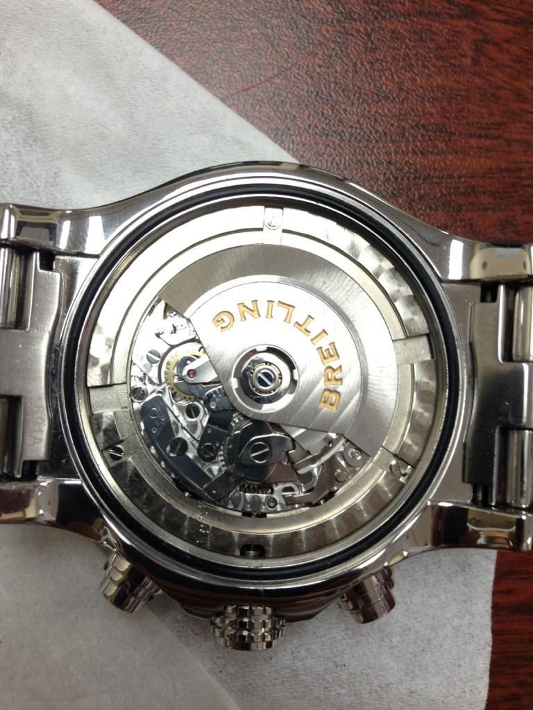

Movement looks right, seeing the dial would help!
PostPosted: Fri Oct 03, 2014 11:31 am
Could you post dial and caseback photos?

Looks real to me.
PostPosted: Fri Oct 03, 2014 1:10 pm
Me too, no idea why the date code is off.
PostPosted: Fri Oct 03, 2014 1:38 pm
well, B has a proud history of effing up their serial numbers to make dating watches interesting.
PostPosted: Fri Oct 03, 2014 2:46 pm

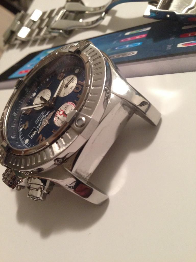

also I did notice there is no little b on the side of bezel,which is usually arount the 12? is this an indication of anything foul or did some years not come with it? thanks
PostPosted: Sat Oct 04, 2014 3:06 am
"b" should be there, maybe it's polished.
Does bezel pearl appear sunken or not?
It should be sunken.

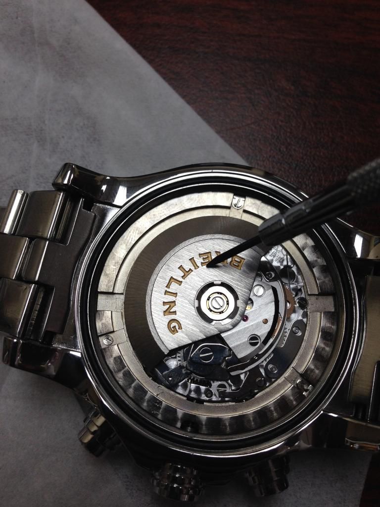

This could be a franken. IMO, a poor one.
If it was 2009,why has it got a Pro 1 bracelet? Retrofitted perhaps, but seems like someone wants to add provenance.
Could be fitted with genuine dial, the movement is an elaborate ETA decorated one but I think the rotor is wrong, it should also have the script in French along the lines of "chronographe certifie chronometre" ? Every B13 breitling I've ever had,had this scripted rotor.
http://www.breitlingsource.com/details/B13.html
Also, the matching serial number should be on the plate of the winding mechanism. I don't see it.
The case clamp screws do not look like Swiss quality, they are a bit chewed up.
There's no logical reason why the B is missing off the bezel.
The fake bezel screws are not actual screws, they just spin and spin. That's one way to check.

Is that a crack on the movement spacer between the crown and bottom pusher?
PostPosted: Sun Oct 05, 2014 3:23 pm
Might be franken.
Dial and date wheel look real to me (dial especially), rotor also (not saying it's a correct one, but fake rotor looks also like this... http://www.breitlingsource.com/details/B13.html ), bracelet is real.
Thing which is odd if it's franken is pushers length, on rep they are little longer.
They don't appear prolonged to me, but it's hard to notice, so might be wrong.
