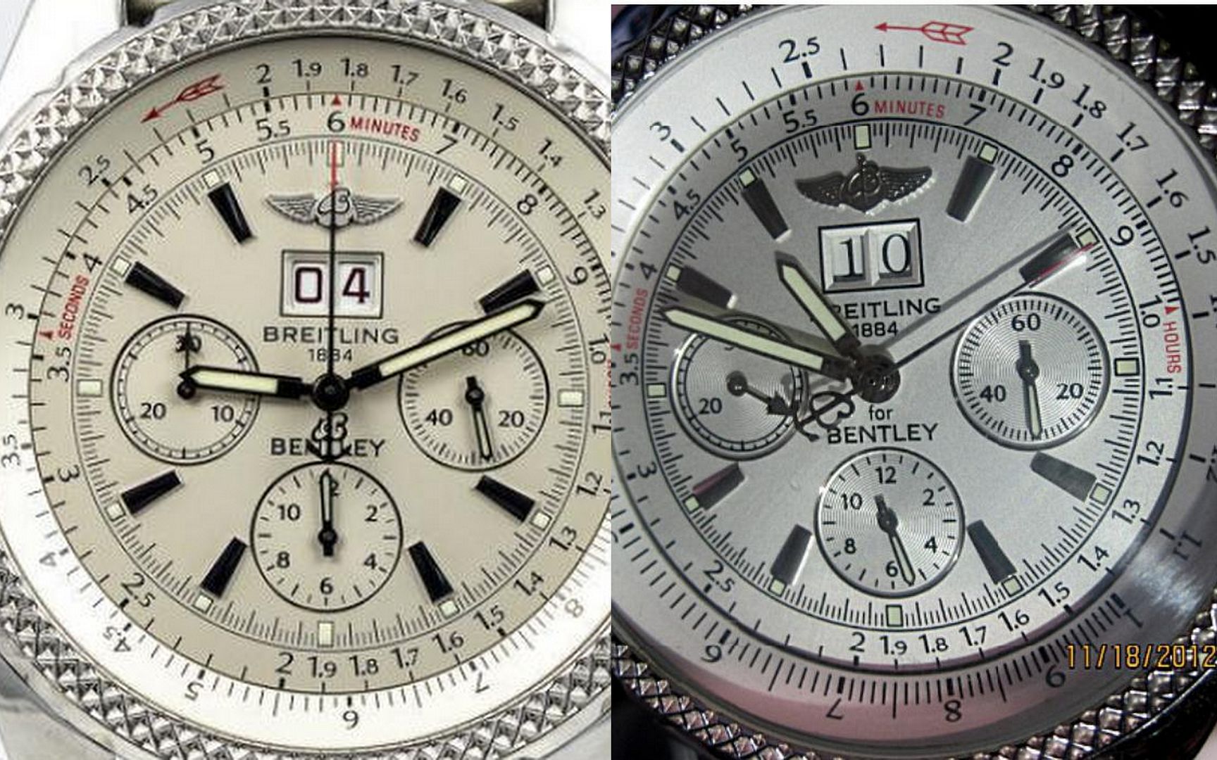

let me add the tells I have listed in that thread:
"gaps on sliderule !
sliderule fonts & arrow
minute hand seems a bit too long ?
as Sharkmouth wrote, date font off."
Gen on the left.

Here a more typical example of the quality fake copy, with correct font size on the 'BREITLING' text below the date. Note how the bottom corners of the date window border extend half way across the B and G chars.
