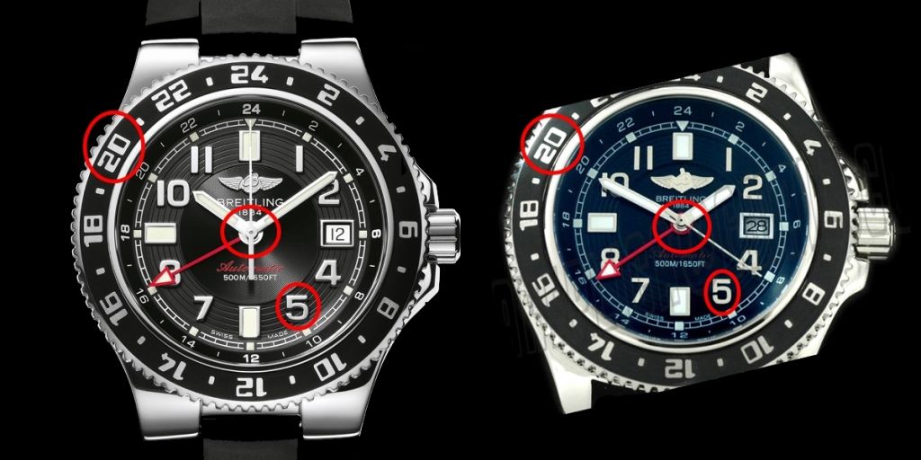

PostPosted: Thu Jan 31, 2013 3:30 am
Here's a side by side - gen on the left.
Main tells are:-
0 in 20 is the wrong shape
Centre ring on GMT hand red, not silver
Gen 5 on dial is square whereas fake is rectangular
As BN noted, the gen date wheel is thinner than the usual font used.
Hope this helps someone from making an expensive mistake.

The lug width are the big giveaway? The real has an integrated bracelet/strap but fakes so far have conventional lugs.
