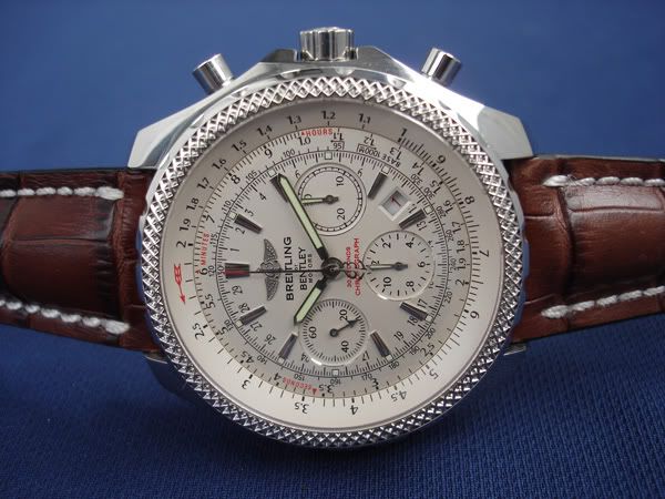

Easy spot. The fake Motors uses a standard Asian 7750 movement so the 3-6-9 sub-dials are for 30 min chrono, 12 hours chrono and 60 running seconds whereas the gen has 60 running seconds, 6 hours chrono and 15 min chrono respectively. There is also the usual sunken date wheel problem as with all 3-6-9 fakes. There's also a quartz model which has a 24 hour sub-dial at 3.
Just have a pics of the gen with you and you shouldn't have any problem confirming it's real.
Edit - just found a pic of a fake Motors on my hard drive. On the left with the gen alongside for comparison.

ok here is a photo - best I could do - the sub dials seemed wrong compared to the current stock so I have walked away - have I done the right thing?

Yeap Bob, That is probably the best decision you've done all year :lol: It's a fake, and not a very good one. It's one of the very cheap quartz-based fakes. Note how close the sub dials are compared to the genuine one.

Holy crap, that's a funky one. I didn't even think to advise you to check to see if the second hand jumped; I just assumed if the guy was trying to pass off a fake in person, he'd at least have the good sense to sell an automatic. But those subdials are a dead giveaway anyway. Good choice walking away, Bob, and good idea to check here before you bought. I'm glad you didn't get burned.
