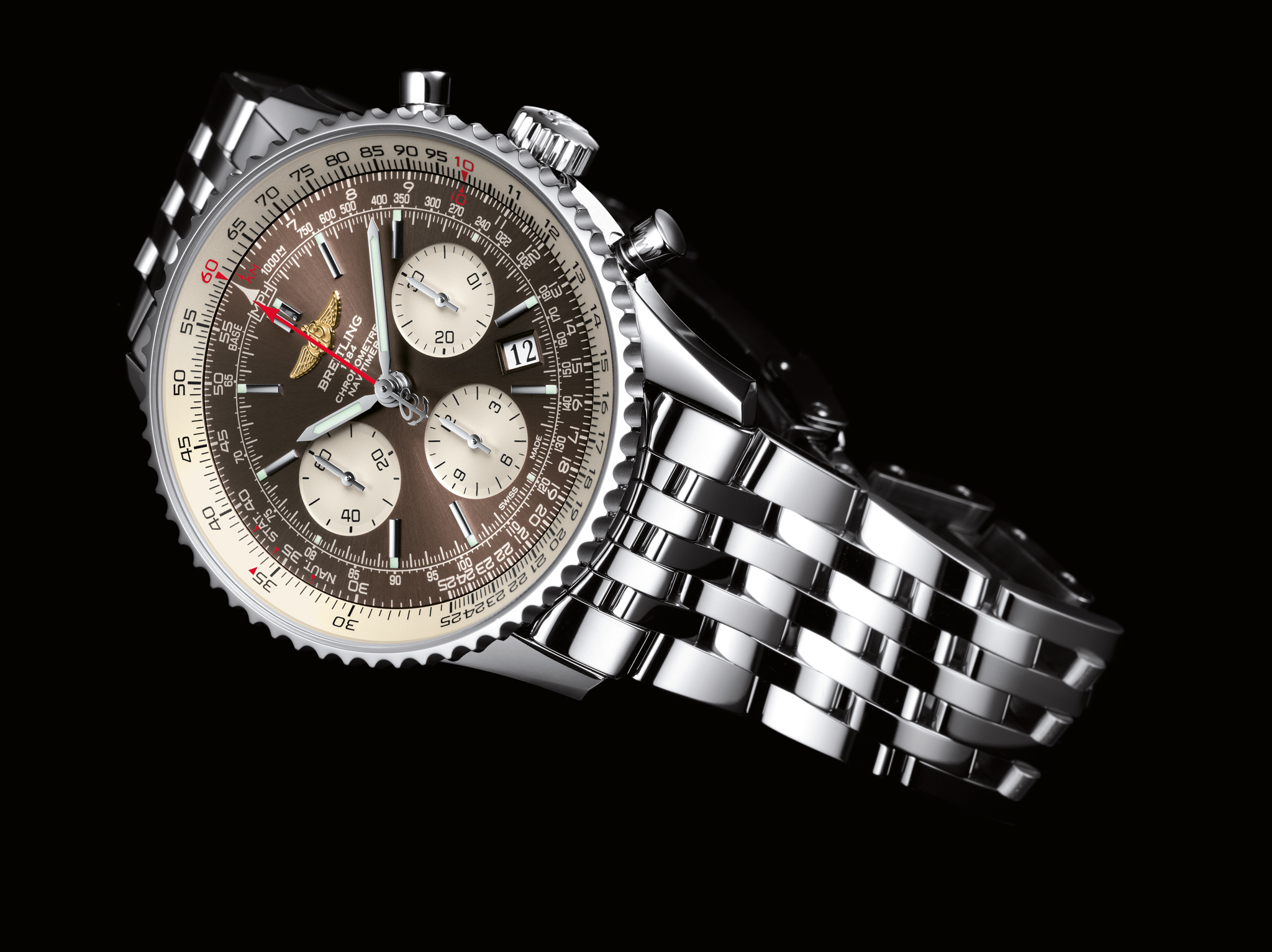

WatchFred knows what he's talking about, as do these other guys on here. I am sure he has given you a detailed accounting of the telltale signs on your watch. I would invite you to visit an authorized dealer and take a close look at a real Breitling. Breitlings are a thing of beauty. They are impeccably finished with perfect printing and margins, flawless alignment of lume dots, high detail in the subdials that you can only really see under magnification clearly, flush fitting end links, etc. Yours is a very good replica but it is still clearly a replica even in my inexperienced eyes. Even just by looking at pictures of it you can tell it doesn't have the quality of a real one.
Take a look at a variant of yours in the Breitling site and see for yourself. This pic is very high res so you can really zoom in and see the details. http://www.breitling.com/media/image/0/ ... erican.jpg
