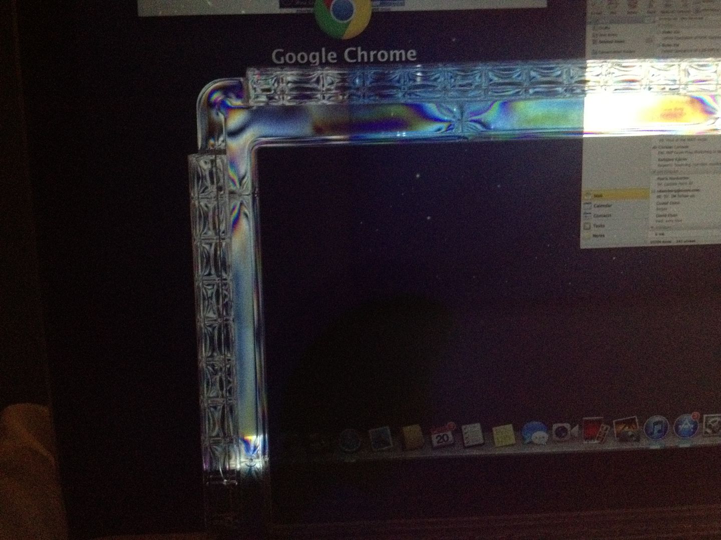

Any idea if any maker has used a polarized glass? Breitling's double-sided AR is awesome in looks (a huge step above anything else) but too fragile relative to the rest of the watch IMO. Sapphire is stupidly hard but you really don't get the advantage of it because the AR coating gets messed up so much easier. My Maui Jims have a polarization that is unreal in reducing glare. Theoretically, polarization wouldn't wear off like an AR coating, and wouldn't be exposed on the external portion of the super hard sapphire...but I say that theoretically as I haven't a clue how it would work with watches.
It depends if the polarizing is due to the material of the crystal or a polarising film. If the film is on the inside it will be protected from scratches. However, if its a film like lets say the top polarizer on an LCD screen (Laptop, ANY LCD display) which is made from cellulose acetate then it may degrade due to UV exposure, so being out in the sun may not be good for it.... however I am sure that its possible to add UV stabalizers to it....
I have a pair of Cartier glasses which have a great polarized lens. However, I find that it gets annoying when using my phone or an atm (anything with an LCD screen) as you get that rainbow effect, same as car windows. For those of you interested in the basic physics behind this is called birefringance, I will let Wikipedia fill you in on the theory . It has a useful effect as the rainbow effect you see is due to internal stress in the opitcal medium (glass, plastic). I have used this phenomenon in the past when working on a project where we were making clear optical parts out of polycarbonate for an infrared military application and we needed to be able to quickly see the amount of internal stress in the molded parts and how different molding parameters (temperature, pressures) effected the amount of internal stress... the pic below shows a plastic part placed infront of my laptop screen then the part and then my sunglasses (any polarizer would work).
for those still reading... this part was molded under about 120T of pressure, this amount of pressure is so high that any air trapped can cause the plastic around it to ignite... basically same principle as a diesel engine... sorry for getting a bit technical... I'm new to the forum and being an engineer with a physics background I just love knowing how things work and why....

 Post subject: Re: Polarized glass?
PostPosted: Sat Dec 22, 2012 12:14 am
Posts: 682
Very interesting! (and a little over my head)! So does that mean if Breitling were to use a polarized coating that they would need to change the pressure the sapphire crystal is under itself?
I have a pair of polarized regular glasses (called Feather Weights Plus) which are polarized and have a scratch resistant coating. In real world usage, they have been very durable. If the viewing issue was not a problem, woud that be an improvement over the AR? From what I've read it sounds like the AR coating itself is pretty hard but watches simply get banged up a lot and often with a lot of force.
The internal stress would depend on the manufacturing process for the crystal. I am sure that it would be annealed as part of the manufacturing process for that exact reason to get rid of stress. As far as the crystal being under pressure it should not be under any significant pressure at the surface, being under water would apply pressure but I have not seen any divers with sunglasses on (though its been a few yrs) so should not be an issue.
