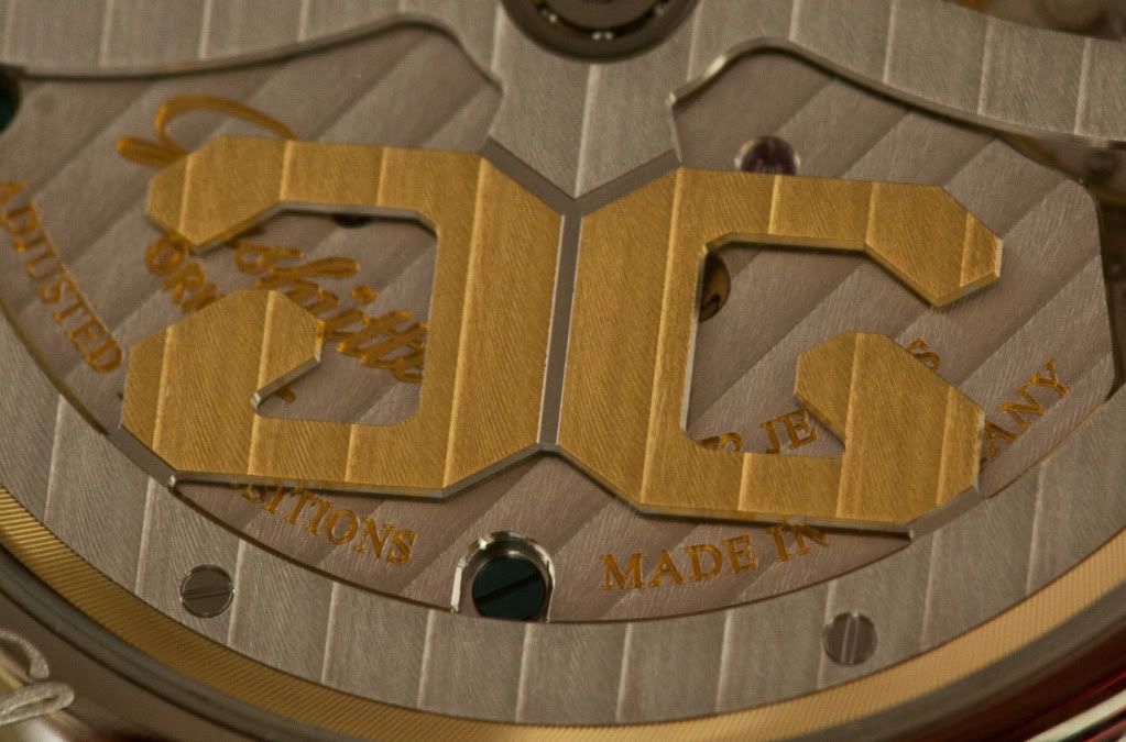

the skeltonized rotor is something to behold, with the large 21kt gold double G logo and perfect hand finishing.

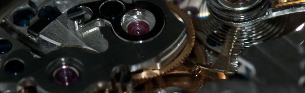

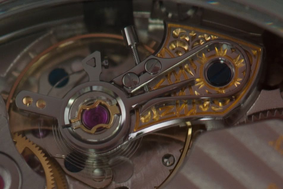

Here you can see the balance cock and swan neck, which has been finely hand decorated as is the Glashutte fashion:

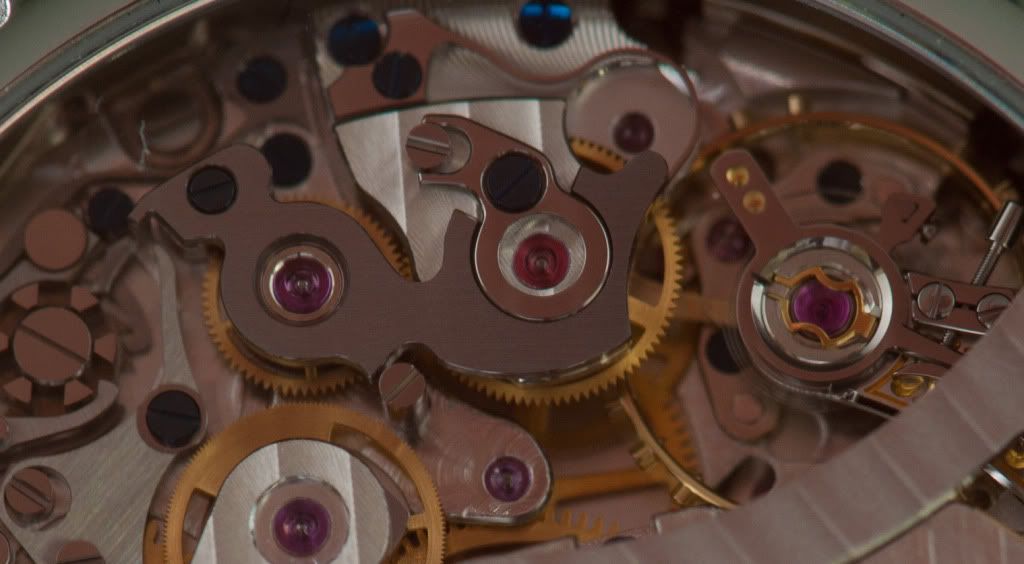

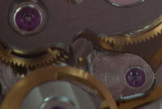

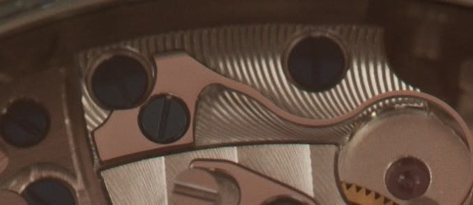

Here are a few more movement pictures, notice the beveled edges! This is a hallmark of higher quality brands like A Lange, and sometimes, Patek! Also hard to miss is the bridges with Glashutte ribbed finish! The movement is framed by a 24kt gold rim and features blued screws throughout.
The caliber has a three quarter plate and features Glashutte's renowned intelligent winding mechanism as well as a 42 hour power reserve. Under the loupe, you can easly see that fine care has been applied to every facet of the movement, from the functional and visual aspects.

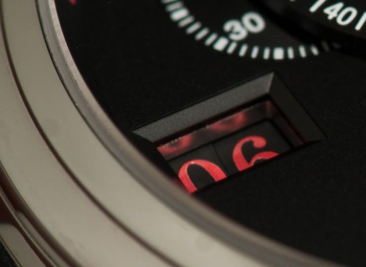

The dial is simply breathtaking, and has to be seen to be appreciated. These pics do not do the watch justice, the dial has a number of elements that add up to a very 3D effect, for instance the date and counter display are quite deep and the edges are faceted and have an internal mirror like edge, which can be seen in this pic.

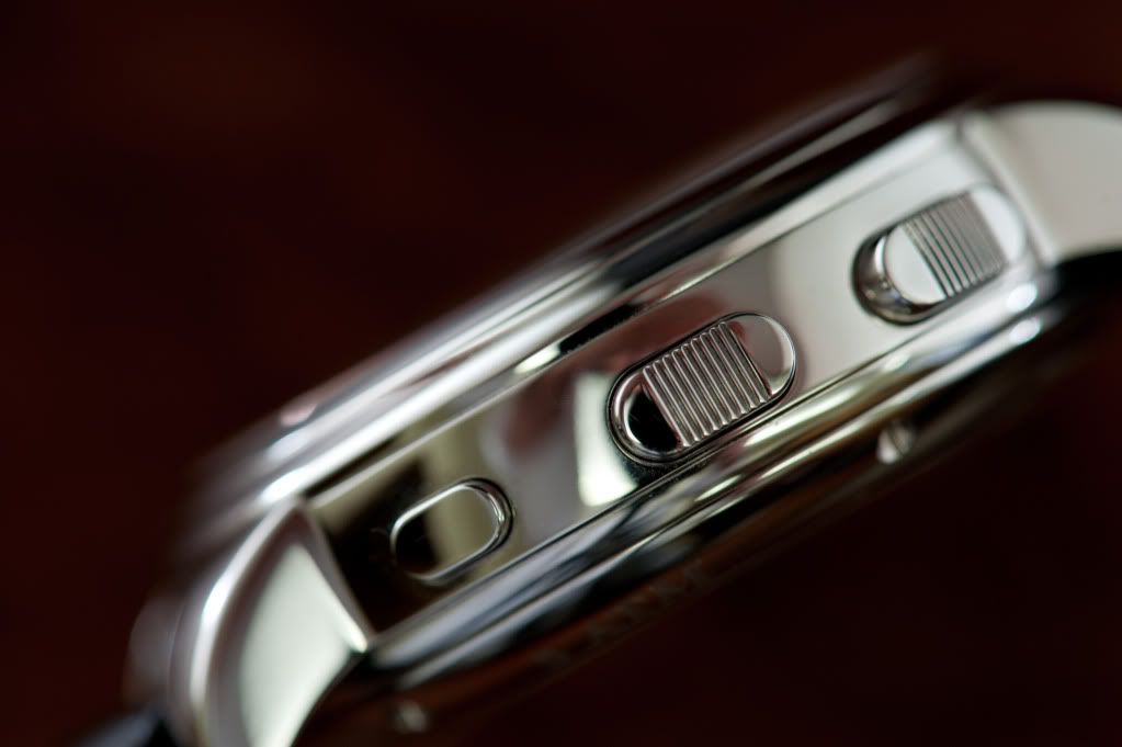

The watch screams quality and attention to detail like no other I have seen, including A Lange or Patek watches. For instance the chronograph movement pushers do not have the usual resistence that you would experience in other watches.
Also, the counter pushers have been very well thought out, the middle one increases the count, the lower decreases it, and are engraved so as to be recognizable by touch, while the top button which resets to zero not only feels and looks different, but has a higher resistance and requires a full push, so as to minimize mistakes! Thats attention to detail my friends!

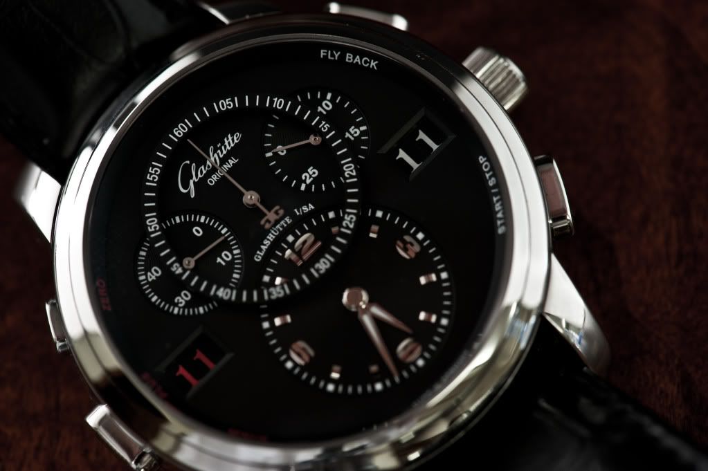

Its not all rainbows and large breasts in Glashutte land however, as there is one unfortunate consequence to having the large counter at its position, mainly the large seconds counter provides exceptional readability but makes it dificult to read the minutes counter when it is at 6 and 7, you have to remember that a partially obsucered minutes hand is 6, and fully obscured is 7.from minute 8 all the way to five is perfect, but still a downside!
The handsome case is 44MM wide and very well finished and polished, it wears slightly larger I suspect due to the watch being all dial and being surrounded by pushers all over.
