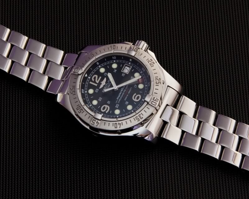

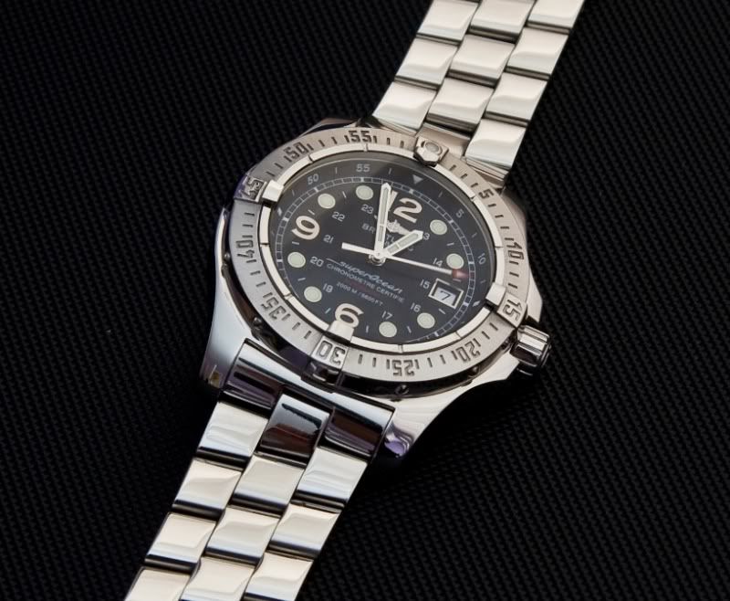

Really wasn't happy with the circular brushing on the Steelfish. It was a coarser grain than the bracelet and didn't match the grain direction either.
So I set about a lengthy polishing mission. Proved to be a lot more time consuming than I thought, as you really don't want to alter the shape of anything.
Removed the bezel and uesd a few different grades of wet & dry abrasive paper to work out the facory grain on the case finishing with 1200grit. Then onto a Dremel with soft wheel and jewllers rouge and a Cape Cod cloth for final polishing. Repeated the process on the bracelet.
Very happy with the results :D

Zirotti wrote:
Any chance you can tell me/post pics of exactly which Dremel attachments and jewelers rouge you used? Much easier with pics :)
To be honest the Dremel played the least significant part. The wet & dry abrasive paper is more important. Something like 500 grit, then 800 and finish off with 1200. Worn 1200 with plenty of soapy water gives you an almost polished finish :wink:
Stole this pic off the net, but its the exact same polishing wheels and compound. It may not be jewellers rouge, but its a red paste that comes in a lot of Dremel accesory packs
Image I use the smaller wheels for lower surface speed
PostPosted: Sun Feb 07, 2010 11:46 am
Posts: 555
Location: Hertfordshire UK
Driver8 wrote:
Looks like a great job! :thumbsup:
Bet it took more than a few hours to get it like that though!
Cheers for the comments guys, and yes it took a very long time, over 6 hours I think :shock:
