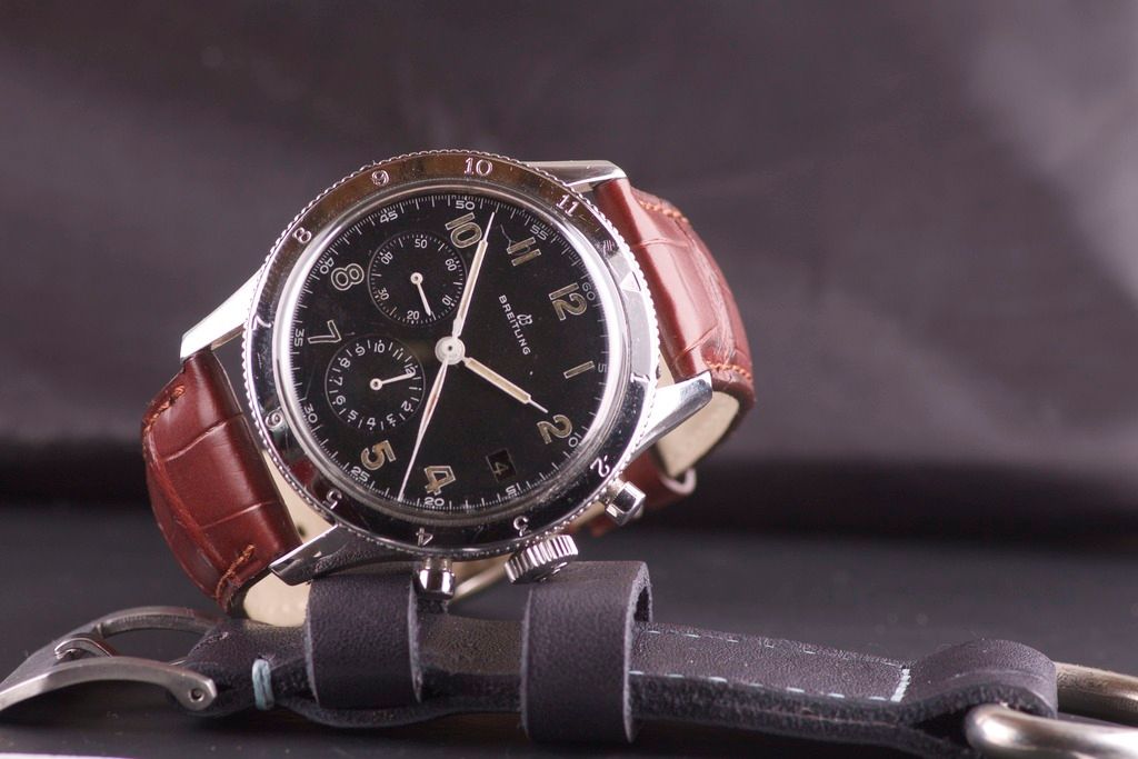

This dial does not look quite right to me, mainly due to the font on the dial numerals (the beginning of the "2" seems too short, doesn't curve enough and square to bottom), and the hour register looks different.
Am I wrong on this? Is this a correct dial? Other thoughts on the piece?

that's a piece offered by Time Classics. walk away.
Will do! Thank you, Fred.

not just walk away but its completely incorrect
its either
1) wrong hour, minute and chrono hand , wrong case and wrong bezel
or
2) wrong dial
#2 most likely
here's what the Initial 'No Geneva' on the dial 765 AVI looks like and what they should look like
viewtopic.php?f=11&t=50565
but if you want one like this , that is correct , please drop me a PM
