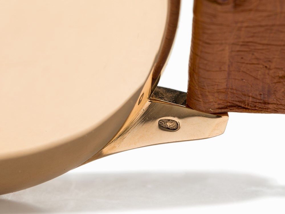

http://auctionata.com/intl/o/67149/brei ... n=barnebys

that is VERY strange. correct ref. no. should be 801, missing serial, dial refinished.
mabe somebody fabbed a caseback or the complete case - the hallmarks are strange/atypical too.
And how odd to give it an 806 mark - the most known Breitling model.

In fact an 801, don't think it would have a signed crown with those hands as they would be for a piece from the 40's not 1965. Would think this is a fabricated case back as Fred says for sure by an inexperienced person in the nuances of vintage Breitling. Don't think/hope this one will make it to auction day.

Agree its a total fabrication
Proof should be the G underneath the ladies head on the lug
G is Geneve , but Breitling didnt move to Geneve until after 53
Ad altho there is no serial number this portrays to be older than 53 ?
And i cant read the number in the key shape hallmark but that shape hallmark has not been used by Breitling afaik ?

I have notified auctionata (and RJ Broer informed them too) about several fakes in their last auction - even had a thread about that. they pulled them, just to relist and sell them in the next auction. They know little to nothing about watches and do not really care, apparently.
