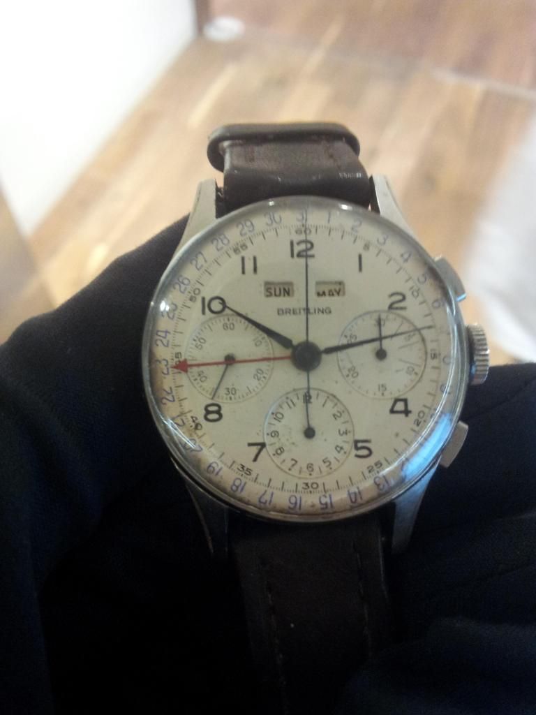

The dial on the triple date is not too "cool" - a really POOR refinishing job! Most likely a fake.

PostPosted: Fri Nov 22, 2013 4:59 am
+1 on this
#4 fake or botched redial too.
"cool" enough ?
PostPosted: Fri Nov 22, 2013 5:01 am
Yeah I immediately assumed that 3 and 4 were duds. #1 is a less common and potentially nice piece but who knows with just dials.

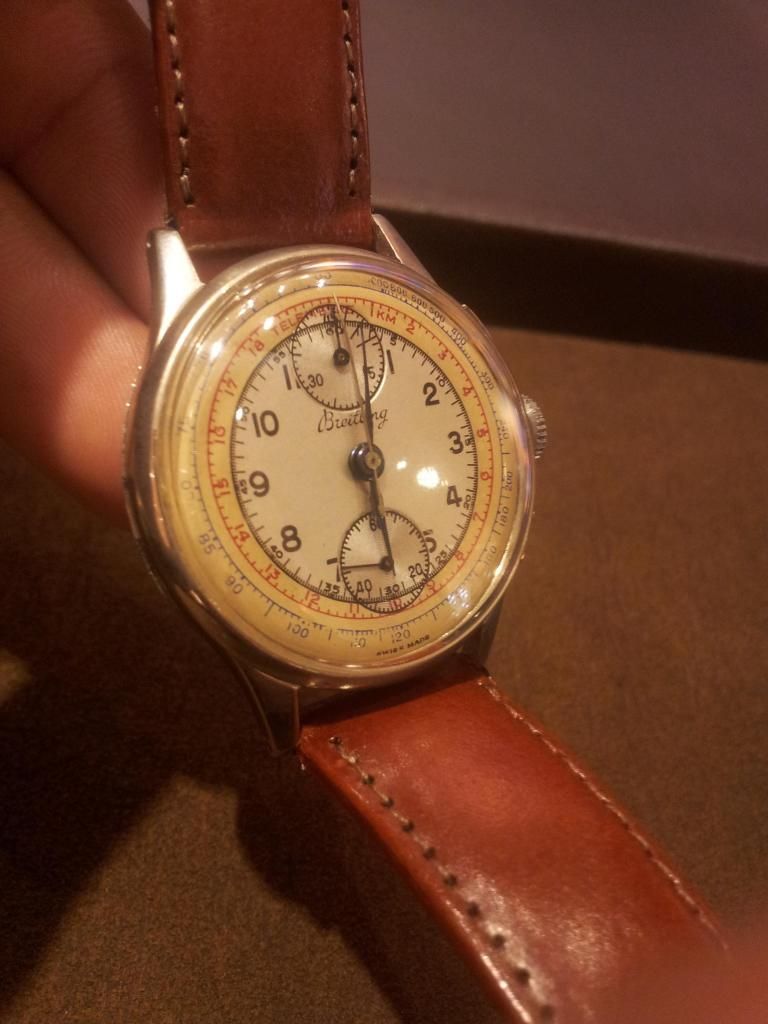

. . . the first one is a 1956 ref. 1190 with a redone dial on which the sub-registers are printed too small and "Giro d'Italia" has been added, well, just for fun, I guess.
you dont believe these are watches that could (warning hypothesis) have been give to Giro D'italia stage winners ?
They were official sponsors in the late 40ies to mid 50ies
PostPosted: Fri Nov 22, 2013 7:38 am
Dracha wrote:
There was a Breitling Giro d'Italia; mid 1950s
bought from the daughter of a Brit who worked as a sports journalist in the 1950s
Bill is referring to the printing quality on the dial, me thinks.
PostPosted: Fri Nov 22, 2013 8:30 am
Giro D'Italia pieces can (obviously not going to say all are) definitely be real - there are a number of different pieces, many of them presented here over the years.
PostPosted: Fri Nov 22, 2013 8:34 am

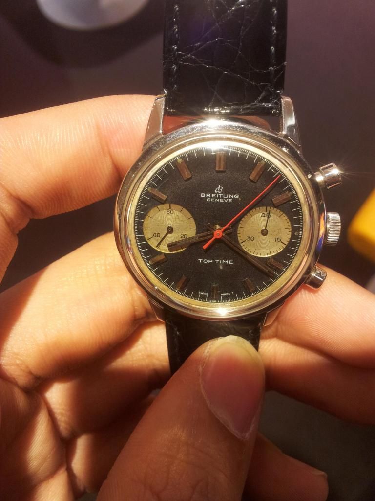

as Roff said in his first reply, we can only talk about the most obvious "tells" here - until we see movements and casebacks (ideally inside and outside) there is no way to tell if watches 1, 3 and 4 contain any authentic components; watch 2 seems to have a correct case, dial and hands are ok.

Here's what I believe, and others are free to believe otherwise.
Using the advertising and the words in The Book (pages 112-113), I believe Breitling sponsored bicycle races only in the years 1949-1952. I think the watches made to note sponsorship of the Giro d'Italia were marked "Tour d'Italie," odd as that may seem. I think Steviepro.wu's example shown here is just one of the "fun" pieces that someone has made up in recent years and some do show anomalies, like ill-fitting registers.
Sorry that my image of that 1952 ad is completely illegible.
