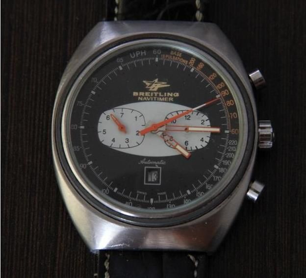

Dear experts,
Pls help me to find out of this watch is authentic.
I tried to find this model on internet but I coudnt find any model like this.
Is this rare or it is not real?!! Tks

a rare fake - never saw that, quite interesting, but total fabrication.

Ouch, thats really bad
PostPosted: Wed Oct 16, 2013 8:15 am
Somebody put a lot of effort into it. Most likely we will see more. I can't picture this is a one of!!!!!!

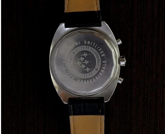

Never seen before and " creative" ... but totally irrealistic if you dig a little. Swiss Air Patrol was initiated in 1964 with only 4 jets. http://fr.wikipedia.org/wiki/Patrouille_suisse
Never seen any vintage Breitling in such "special edition" . The recipe came 15-20 years further : Breitling SA started the " Patrouille" editions with the Chronomat Frecce Tricolori and extented the recipe to Navitimers in 1992-93 ( Patrouille de France ).
Question : what can be the automatic caliber used with crown at 3 and 2 subdials in a " supposed to be circa 1970" watch ?

Clearly no vintage calibre - it will be a Chinese 'faux' chronograph with the pushers advancing the 'day' subdial.

This is an interesting piece. If it could only talk, but if it could I think that Roff is on the right track here and we would need a Chinese interpreter to get the story straight.
