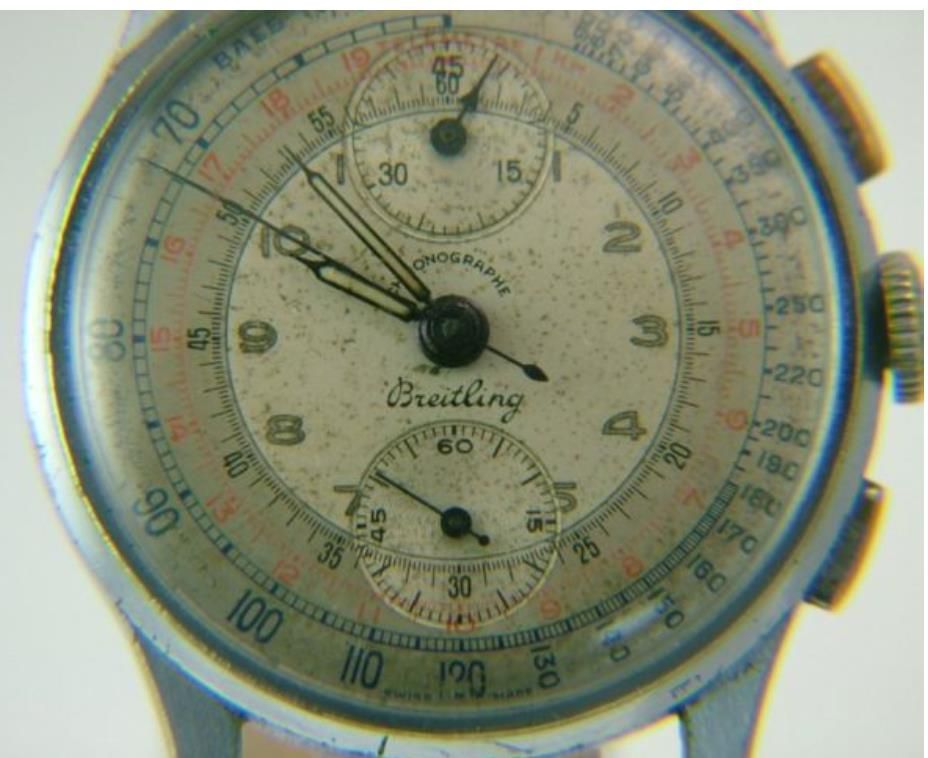

Hi all,
I've just bought this at auction in the UK, and I think it's "right" but would appreciate the opinions of more experienced and knowledgeable fanatics!
It has a different dial to any I've seen, with the brand above the lower sub dial instead of below the upper, is this unusual? When it arrived the case is in pretty good condition, but had years of crud around the crown and pushers, and the bracelet was evil, but a few turns and she's running, keeping perfect time, and the chrono is working, although sticking slightly at about 34secs. I've since replaced the cracked glass and filthy bracelet, cleaned the case up (but will not polish it), and it could do with a service.
I would welcome any opinions or suggestions!

sorry, but this picture is pretty useless. please post decent pics, including inner/outer caseback and movement. 460xxx would probably be a bit earlier even, though there are no yearly records b4 1944.

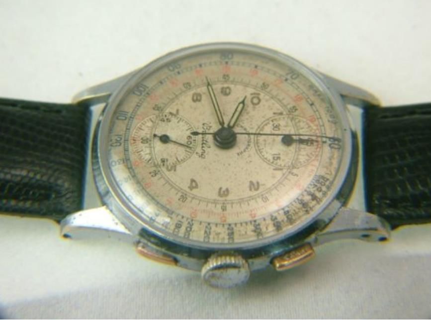

apologies, realised how poor pics were when it posted, have posted a few more I've just taken

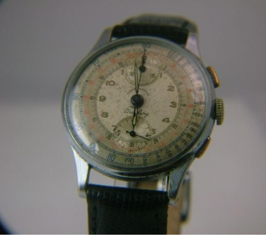

Posts: 7
More photos

If someone is going to rebrand a Chronographe Suisse as a Breitling they should probably remove all of the original name from the dial.......
Sorry, not a Breitling.

You need to seriously post better, larger, pics for an honest opinion. These early models are the easiest to turn into something else because the movements and backs are seldom stamped with the manufacturers name. The location of the Breitling script on the dial should give even a novice pause when he see's that. You just don't find the Breitling name there on vintage pieces. The fact that watch has the correct patina means nothing since the donor watch is of the correct age so everything else would look correct. I would look carefully at the Breitling script through a loupe to determine if it's aging is the same as the rest of the dial.

Most likely the Breitling name was added to the dial many years ago. Regardless of how it got there, Breitling NEVER signed its name on the lower section of an up/down Venus 170 dial. It is not a Breitling.

well, we have a pretty unanimous position here.
not only did I never see a Breitling script at 6, why would Breitling put "chronographe" on this dial, something they never did on any of the thousands of chronographs we have seen ?
we have seen fakes that seemed to be decades old and had been in families for generations - so this probably is not a recent fake - current fakers would have added the incorrect logo engravings on bridge and caseback.

let me add some pics of that fake again, as member emergency10 preferred to remove them and the thread is quite worthless without those.
lug design is inconsistent with both the Breitling ref. 176 and the ref. 178, btw.
funny how somebody who "sells around a million £'s worth of Breitling a year" finds it necessary to cheat and lie in his listings and can go from "Don't get me wrong, I have the upmost (probably meant utmost?) respect and bow down to your extensive and vastly superior knowledge and experience in the Breitling world, I could not have hoped for a better responder to my post, despite not being the response I wanted" to "If you could read I didn't ask for anyone to tell me it was right, just whether they had seen similar before. Didn't mind your opinions, just the arrogance with which they were expressed". :wowzers
