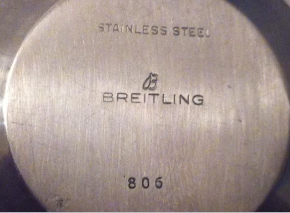

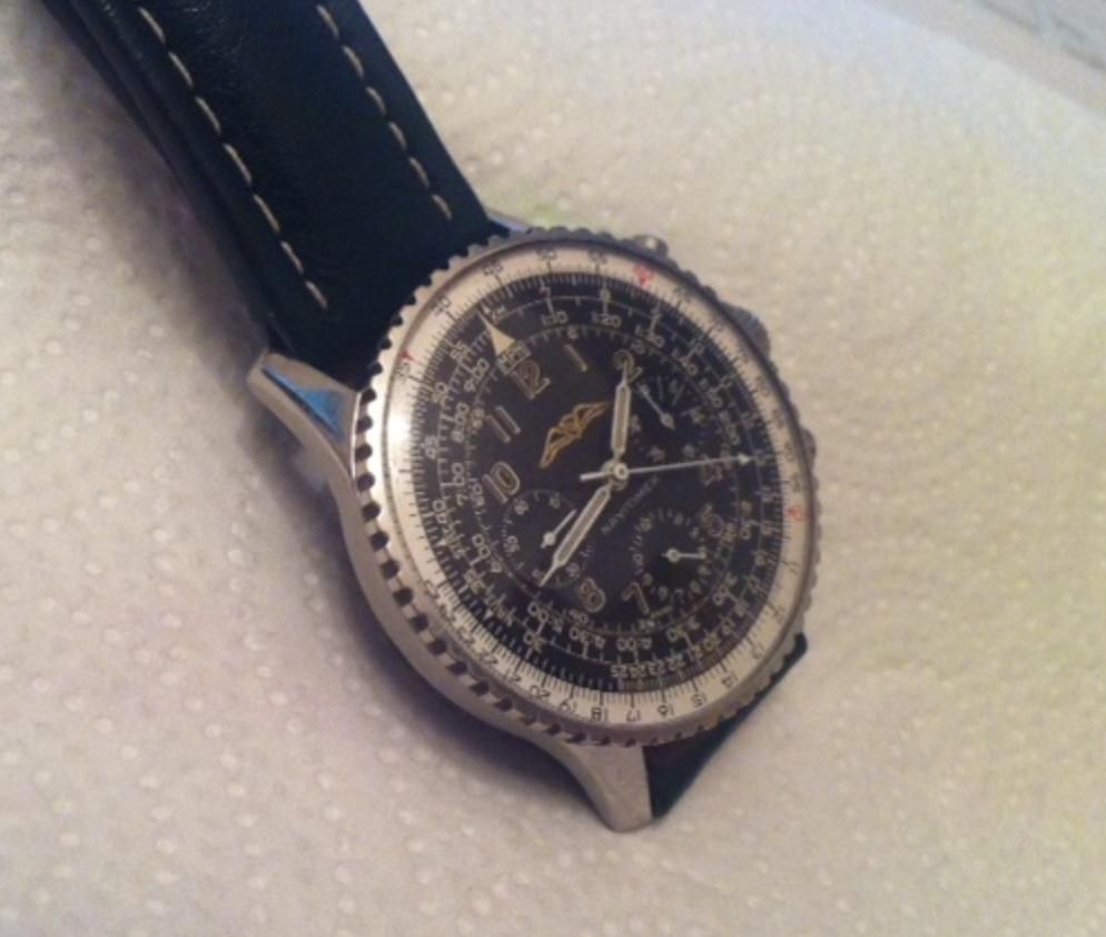

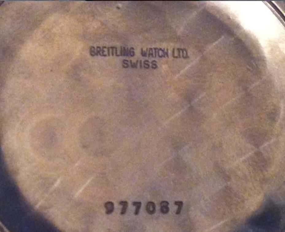

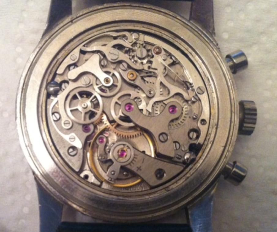

well, this one has me scratching my head, as I would have assumed it was impossible,
a 1964 Venus 178 case should not fit the Valjoux 72 movement (that has no manufacturer marking or import code) ?
dial does not have the V72 "Dracha OPA shrugging wings".
http://www.ebay.com/itm/110959942063?ru ... 26_rdc%3D1
confused.

It's pretty easy to tell it isn't a Breitling Valjoux 72. Definitely a later, non-Breitling, movement. The difference in the design of the balance cock along with the minute jumper spring having two screws vs one (for a later model R72 which is adjustable) are just a couple of things that jump out. Isn't the Valjoux 72 Navitimer case supposed to have slightly offset pushers or something? Looks like a home made movement ring too.
PostPosted: Wed Oct 03, 2012 9:45 am
Paul, yes, movement is clearly wrong, but as you state, the Valjoux case for the 806 should be different from the V178 version, with the asymmetrical pushers - afaik no such cases were manufactured in the 1960s - most definitely not in 1964, bezel looks off too, dial ring seems even later.
a very, very strange piece. but the "homemade" theory seems not too realistic, maybe Kurt has an idea how this thing could "happen". at least the seller does not claim it is a prototype.
