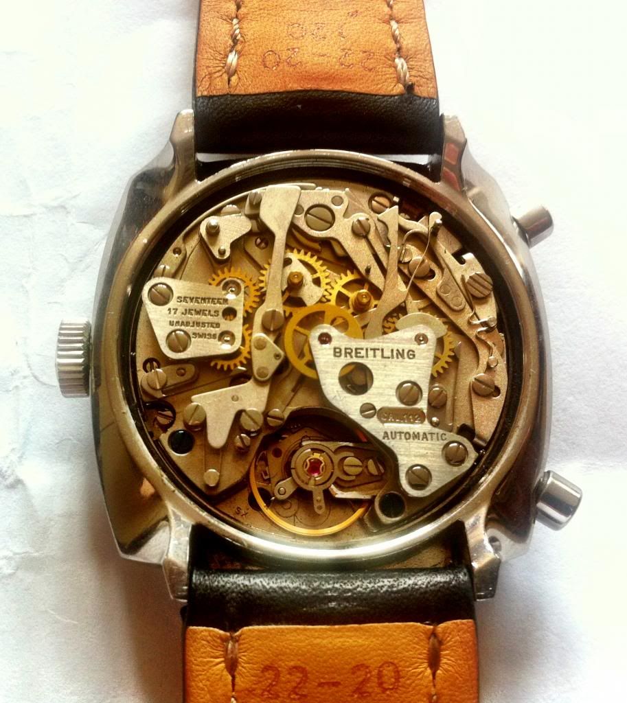

What do you guys think about this one? My special concern is the bridge. It says cal. 112.
 Post subject: Re: Ref 2111
PostPosted: Sat Jun 22, 2013 2:58 am
cal 11-2 is the nickel plated high beat version; correct
PostPosted: Sat Jun 22, 2013 5:57 am
Yep, also has an upgraded mainspring, different 4th wheel and escape wheel (to get the frequency up to 3 Hz.)

I wonder why it has automatic on it though? Not a question of its authenticity, just a 'what the' query?
PostPosted: Sat Jun 22, 2013 12:31 pm
because it is ? Cal 11 is one of the three first (different definitions) automatic chronograph movements, launched in 1969, developed by Breitling, Heuer and Bueren; slightly later version here.

Well I'll be. I'm used to seeing a rotor on auto movements. Can I ask, how does it work?
PostPosted: Sun Jun 23, 2013 12:26 am
it is a modular movement, there's a micro rotor below that chronograph module.
excellent information here: http://www.lesmala.net/jean-michel/navi ... omatic.htm
