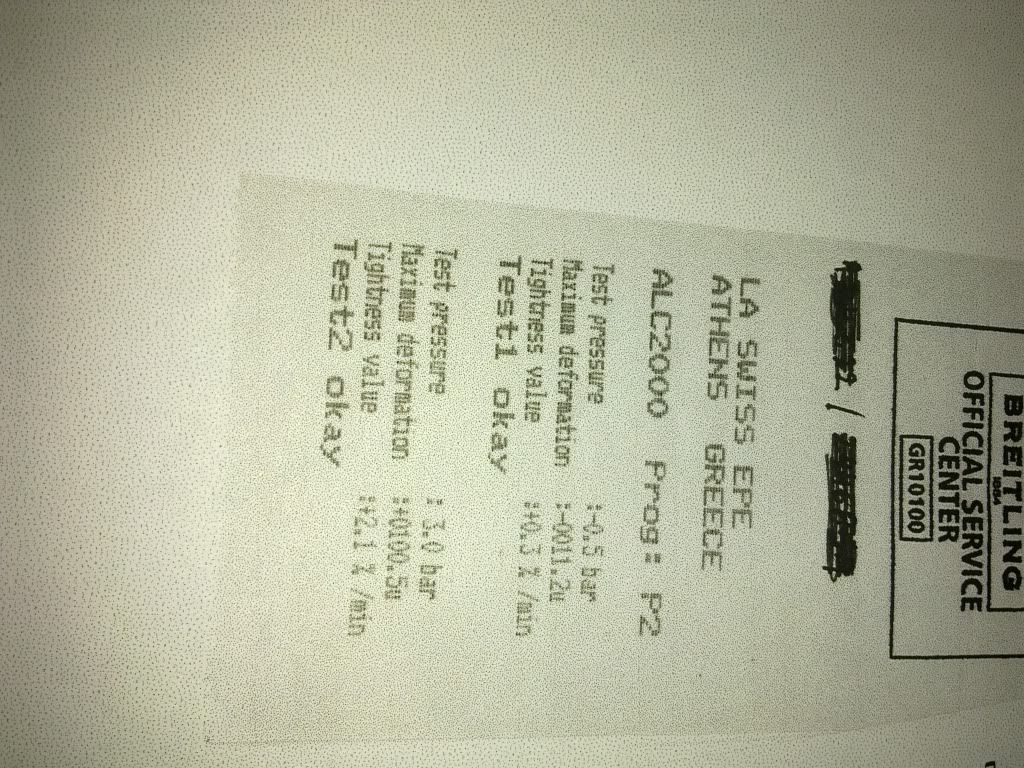

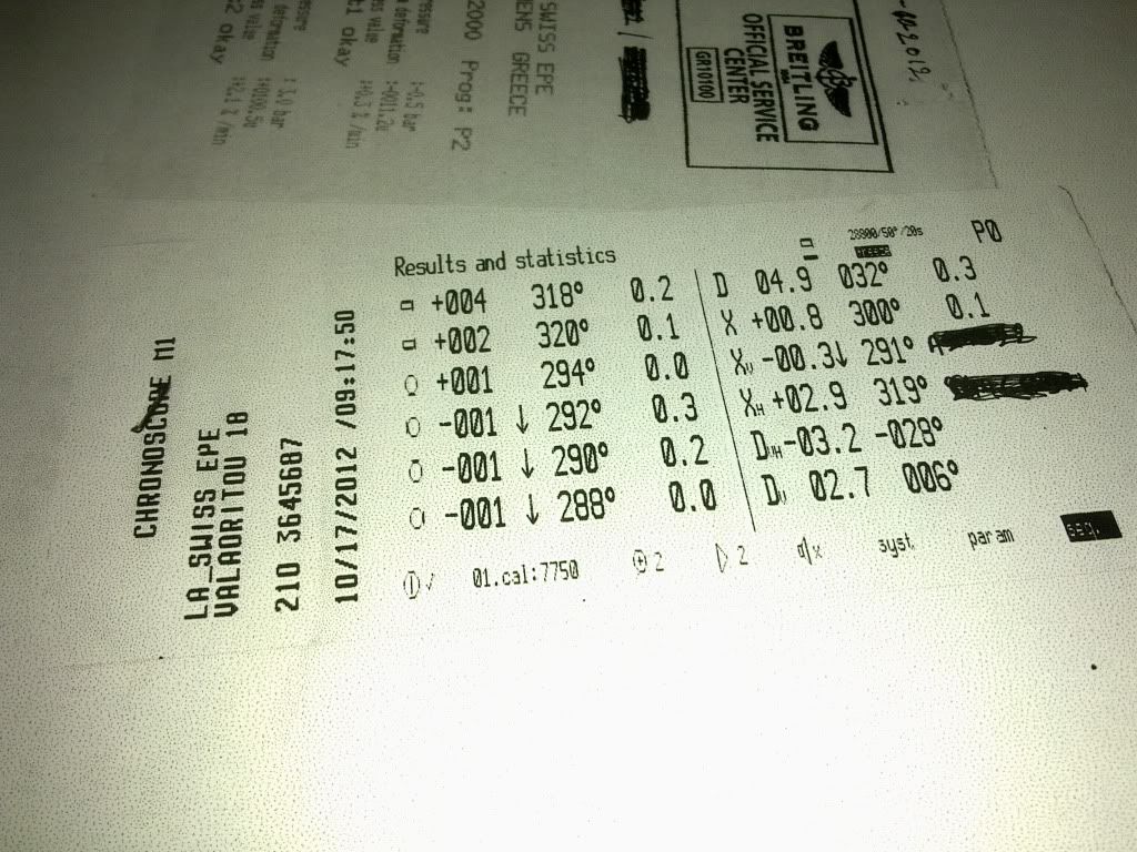

Hello there, Just received my watch back from service and I was given the attached report, Can someone please explain that report for me .
Thanks

The first is the pressure tests measuring case deformation and air leakage as a result.
The second is the rate test showing the rate variation in each of the positions and he amplitude of the balance (amount of rotation) which contributes to prolonged accuracy and consistency of rate.
In plain language it means that the watch is running about 2 seconds a day fast and has good seals.
