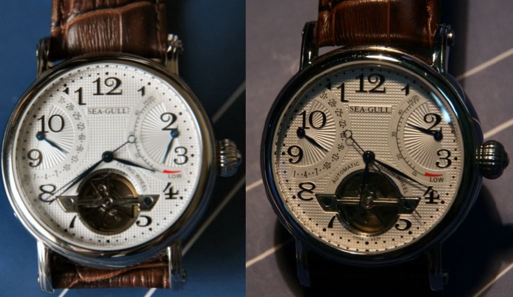

Here is a result of wearing a Chinese watch for around three hours mostly sitting at my desk in front of a computer and going for a half hour walk to the shops.
Note the difference in time and the power reserve which happens to be quite accurate despite it being a Chinese movement,

That's missing the variable of the rotor gearing though - turns per day and direction will have a major impact on the amount of activity needed - a 650tpd bidirectional gearing will wind a heck of a lot faster than a 1200tpd unidirectional gearing.
PostPosted: Wed Apr 25, 2012 10:20 am
@wessa
How much is the real power reserve?
PostPosted: Wed Apr 25, 2012 10:43 am
bnewbie wrote:
@wessa
2 minutes. :wink: :poke:
(Just kidding Wessa!)
