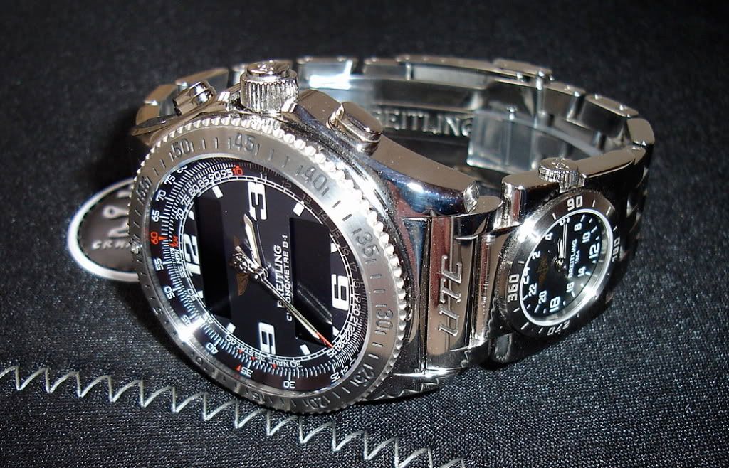

PostPosted: Tue Nov 23, 2010 6:41 am
Likes: 303 posts
findo-400 wrote:
The 22mm Pilot bracelet with the 350A end links from a Headwind will fit both the B-1 and B-2. HOWEVER, there will be a slight gap (about half a millimeter) between the endlink and the case. As it is not a "snug" fit the endlink will move against the case. Also ithe top profile of the Pilot does not follow the curve of the case of the B-1 and B-2, but in my opinion the Pilot still looks great on a B-1 or 2
There is also the option of using the 354A or 357A endlinks too but the 350A is considered the best fit.
Hope this helps.
Gav is absolutely correct. I have fitted both the 350A (Crosswind, Headwind) Pilot bracelet and the 357A (Chronomat Evolution) Pilot bracelet onto my B-1 (Identical case and end link geometry to the B-2. The 874A "Fighter" bracelet is specified for both watches in the Sales Handbook.) and although they look nice, the gap is noticeable when the end link rotates its flat surface away from the case. Below is an older pic of my B-1 with the Evo's 357A "Pilot" bracelet attached. Before I took the pic, I "nudged" the end link against the case so the gap would not be noticeable. Further, as Gav indicated, the shoulder "arch" of the B-1 or B-2 case is not matched to the "flat" top edge of the Pilot bracelet like the correct 874A "Fighter" bracelet end links. Hope this helps...
Best,
Ron
