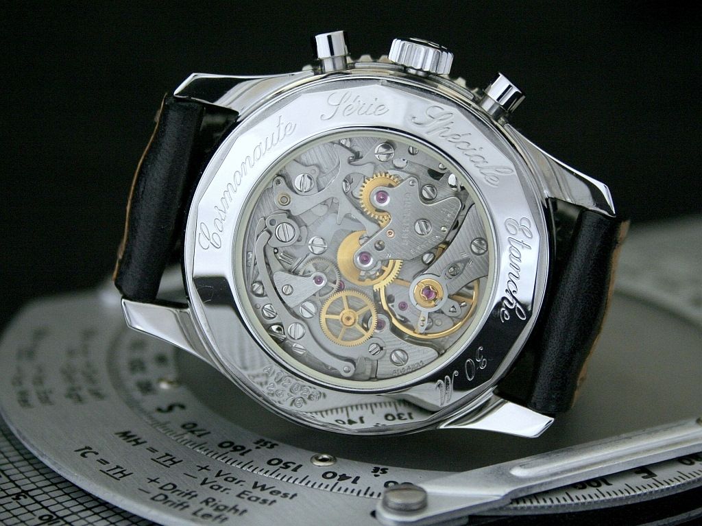

PostPosted: Thu Nov 04, 2010 6:44 am
Likes: 303 posts
Optik22 wrote:
Ron,
those pictures are a piece of art.
The slide rule shown is it a part of Breitling or from somewhere else?
Hi, Optik and thanks for the comment. :) The prop in that picture is my CPU-26 air navigation computer which was quite useful to me in years past. Like the civilian version E-6B computer, it was sometimes called a "whiz wheel" by users. Many of the functions are duplicated by the bezel slide rule functionality on some Breitling models such as the B-1 and various Navitimers. Do a forum or Google search on the subject and you'll find lots of interesting information. Below are a couple more shots of the CPU-26 taken with my display back Navitimer Cosmonaute...
Best,
Ron
