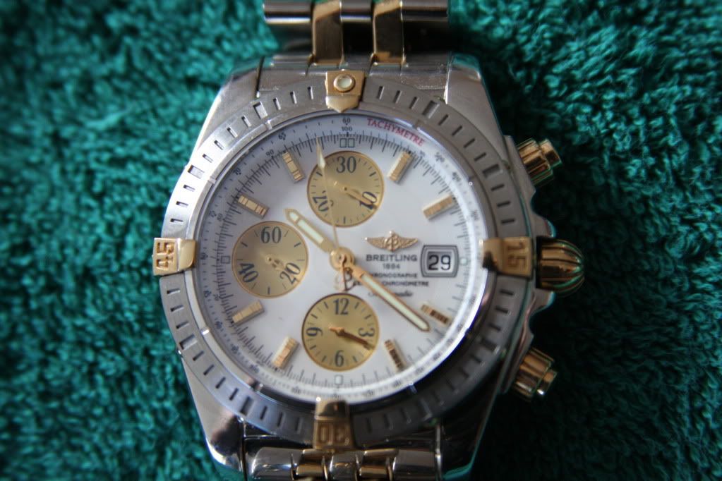

Location: Orpington Kent UK
Hope this works
Chronomat Evolution
Omega Seamaster
PostPosted: Sun Jun 28, 2009 4:49 pm
Contributing Crackpot
Posts: 2423
Likes: 4 posts
Damn! That is Gorgeous! and familliar.
