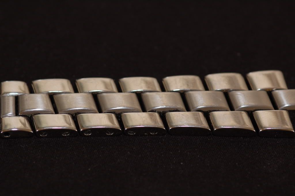

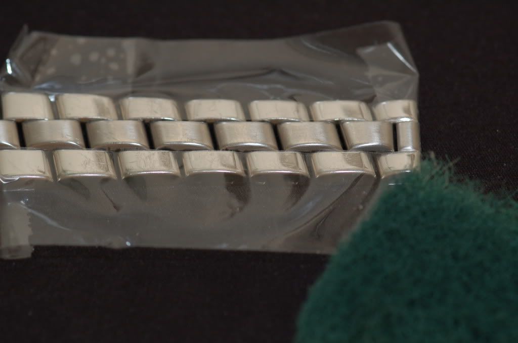

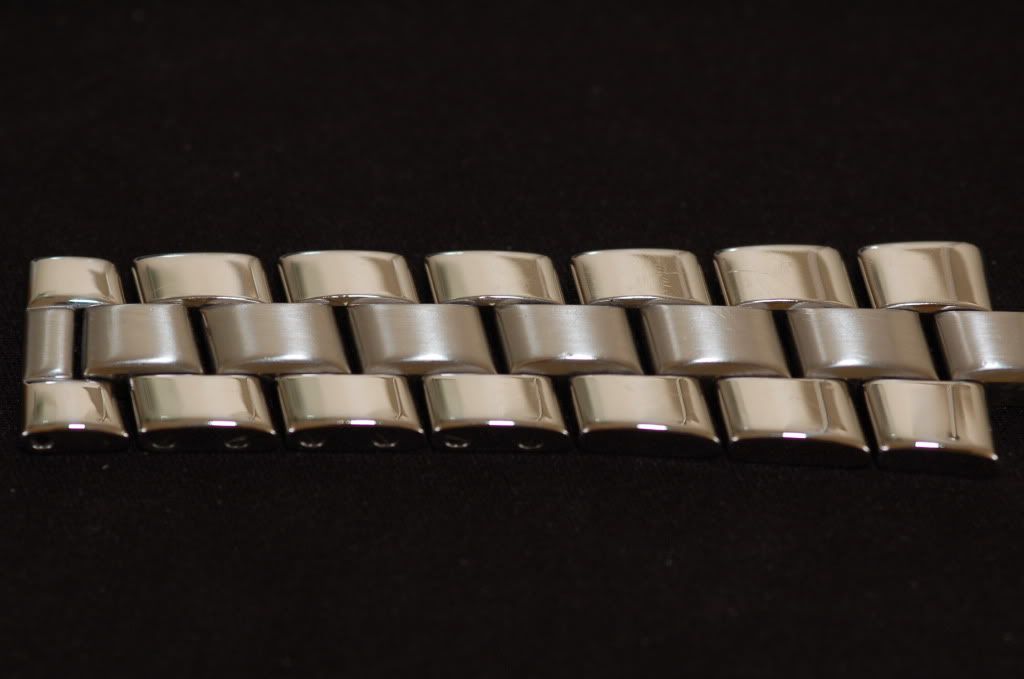

OK - I don't know how this will look on the photos but in the flesh it is a big difference.
I also did a bit of Cape Cod polishing on the outer links. But the whole thing took about 20-30 mins. As with anything, the more time you take the better the results.
So - Before:
During:
After:
Enjoy, it's great to give it a bit of a buff up.

wow! after reading this technique over and over on this forum i have always wondered if it really looked good and factory after you were done? Well you proved that it not only looks AWESOME it looks perfect and factory as well! Great DIY job!
