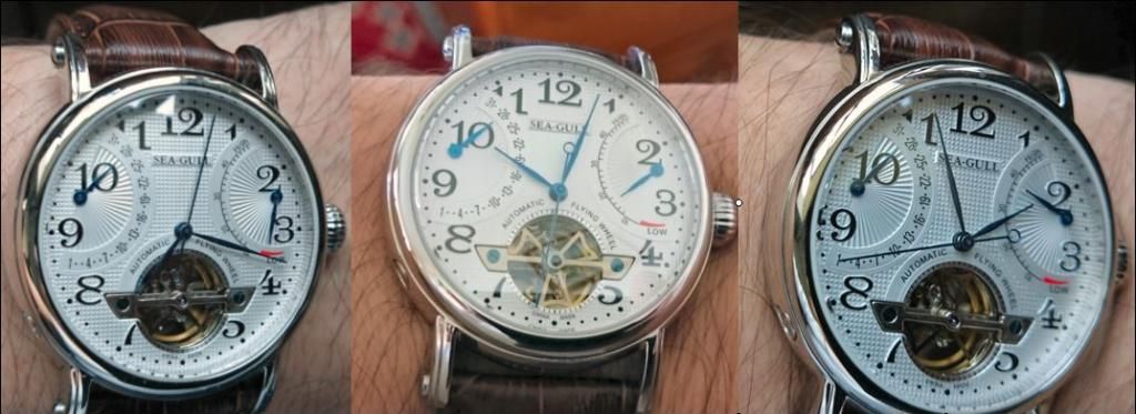

OK, a bit of an experiment here for you.
I had to dust off one of my "toy" watches for this as it is the only automatic I have with a power reserve indicator.
The watch was at a complete stop when I picked it up this morning. I gave it 3-4 turns of the crown just enough to get it ticking again and set the time as you can see in the first picture.
Take note of the power reserve indicator just under 3 hours later at 10AM and 4 hours later at 2PM.
I can not claim to be very active right now. The opposite could not be further from the truth, I would be asleep if I moved any less as I am on crutches recovering from a nasty fracture of the calcaneus.
Based on this I say there is something wrong with your watch.
