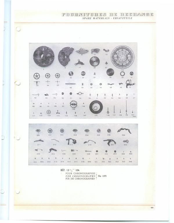

Here is a little bit of info on Landeron 50 movement used in Breitling. The first scan is from a 1952 Bestfit parts catalog. Note the calibre number 104, which is a Landeron 50 movement.

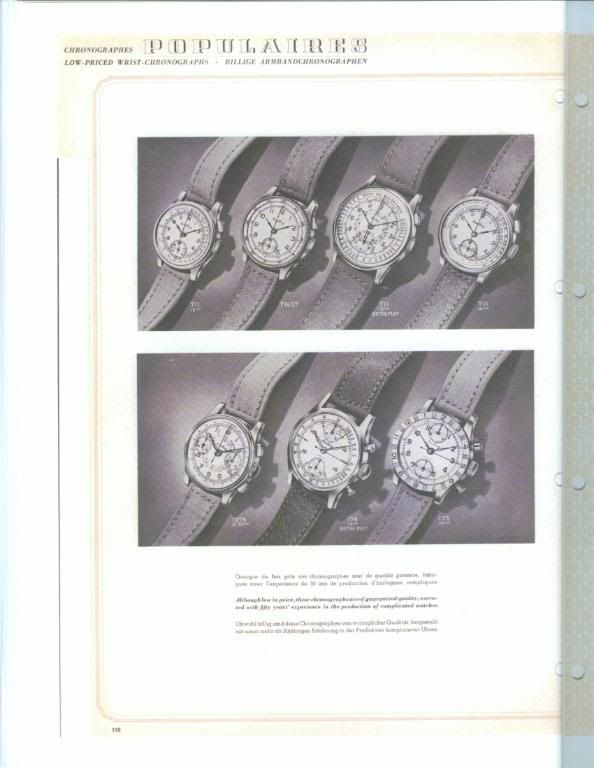

The second scan is from the parts list in the Breitling catalog 46. It shows the calibre 104 breakdown and also shows it is used in reference # 1375.

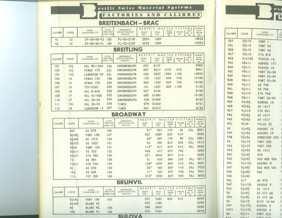

The last scan is also from catalog 46 showing the line of inexpensive chronographs. The bottom left is reference # 1375. Note that it clearly has square pushers instead of the usual rounded end used by Breitling.

PostPosted: Thu Feb 19, 2009 9:30 pm
Posts: 3806
You're not alone in finding that interesting!
PostPosted: Fri Feb 20, 2009 2:52 am
:yeahthat
PostPosted: Fri Feb 20, 2009 5:52 am
I wish the direct Landeron reference was in the Breitling publication rather than a 3rd party parts supplier. Landeron movements have been showing up in vintage Breitlings for years and I have never seen even one that was real.
Some of the parts of the 104 do look very Landeron like - especially the plates, I'll need to take a closer look and Craig's insight will also be valuable.
In terms of the square pushers - less common for sure, but there are quite a few square pusher Breitlings.
Definitely a very interesting post.
