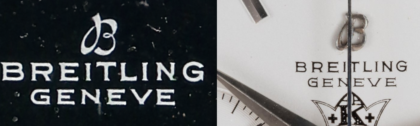

someone will have to convince me this is correct , and on this one I am not easily convinced
look at the sloppy 'Breitling' , height difference between the individual letters , the sloppy overall print , the placement and font of the Premier (and the overall white without any of the sunburst or other effects on the dial)
https://www.ssongwatches.com/blogs/jour ... ng-ref-734
nicolas07 likes this post.
PostPosted: Fri Dec 15, 2017 1:43 am
side by side
a dial from 1953/57 and the ref 734 (which is supposedly from the mid 50ies ?)
and this may not be a popular opinion but I am not even close to the fence I like to sit on

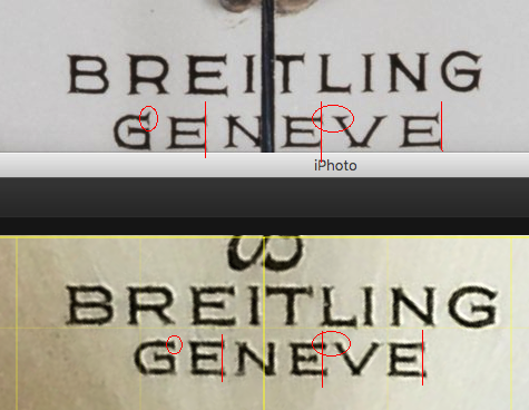

PostPosted: Sat Dec 16, 2017 7:17 am
Since there seem to be a bit of controversy around my post and people don’t believe me here’s a bit of extra info as to how I come to my ‘this is a reprinted dial’ conclusion
And for the record , I am not closer to the fence , if anything it convinced me more its a reprinted dial
Ok , so I am going to focus on the Breitling print first and later I will take the whole dial with KS branding in consideration \
1) I put both scripts (of a know good 1950ies 788 which seems to be an equally rare watch ) above each other and took a screen shot
2) now before we go much further , look at how the ‘Geneve’ is positioned under the Breitling , and please compare yourself with hundreds of Breitling watches on the web that have ‘Breitling Gevene’ on the dial below each other
this by itself should be quite convincing ?

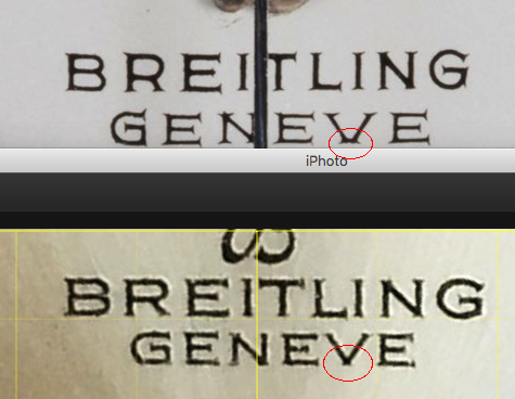

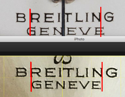

3) so more inconsistencies
bottom of the V sudden different from all others I have seen (and please remember the 788 I used as an example is just as rare as the 734 so IMO this negates the ‘its a small production run’ differences as the 788 is spot on and consistent will all others with this particular script on the dial)
4) R & G completely different
5) where do all of a sudden come the very pronounced serif’s from on the ‘Geneve’ ?
