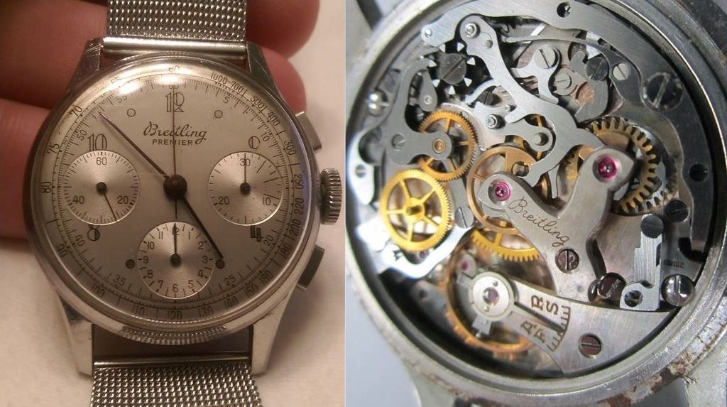

I did not want to distract from the ref. 797 on display there, but have side questions about my SS ref. 787:

I have a SS ref. 787 with a serial number that dates it to 1945. The dial/movement/case all appear authentic, but I have suspected they were a marriage at some point. My suspicion was based on the following:
1. The watch has replacement pushers and crown, so it is certainly not 100% original.
2. I read somewhere that "Premier" was only used on dials housed in solid gold cases (not the most reliable source).
3. The bridge is signed "Breitling" but not "Premier" like I have seen in other examples.
I purchased this as a frequent wearer, which is why I was not overly concerned with the originality off all parts. If I learn its more original than suspected, I will be very pleased. WatchFred has enlightened me regarding Premiers and gold cases, so I can check that off.
However, I am still uncertain about the bridge. To me, the movement looks like a proper Venus 15x but the bridge isn't engraved "Premier" like the examples I have seen. So this leads me to two questions: First, is there any reason to believe this is not a Venus 15x movement (seems unlikely to me, but I must ask)? And second, are there other examples floating around of genuine Premiers with only "Breitling" signed on the bridge?
As a side note, WatchFred, the strap came from your Cypriot friend :D Great recommendation I found on another thread.
PostPosted: Wed Apr 13, 2016 10:39 am
bridge is fine, 797 is the only ref. I know that I've seen only w/ bridges marked Premier - maybe because all I've seen were made in late 1946 and 1947.
basically we go from unmarked to marked bridges in the early 1940s, then slowly Premier is added to on some models.
if u search through the forum a bit you should find several threads about the subject.
yes, it is a Venus 152
Joseph85282 likes this post.
