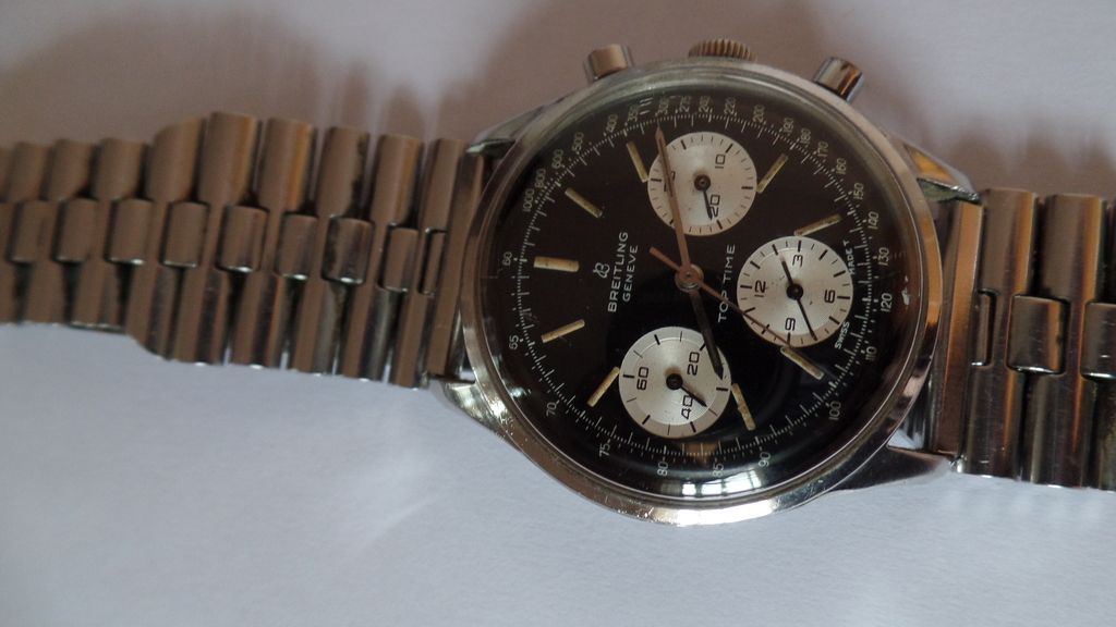

Hi folks, a seller on another forum is putting up this Panda 810 for sale. No pictures of the movement or the crown so far, but I've asked for them.
Based on my limited knowledge so far, would I be correct to tsay this is a 810 , and that it should contain a Venus 178 movement?
Also, any red flags about the watch so far? AFAIK it seems similar to other examples on the web and Fred's, so it seems OK.
Pictures of the movement would be crucial though, so I hope the seller sends them soon. But if there are obvious signs this is a franken, then all bets are off of course.
Thanks!

The 12 hr sub register hand is wrong and the lume on the dial looks a little thick. I'm pretty sure that bracelet has had the ends cut down to fit the watch. The price is probably in the ballpark.
Ah, I missed that! Thanks for pointing out the problem with the hands.

watch is a basically correct execeution 1, assembled in 1964 or 1965, would be VERY suprised if the movement wasn't correct too.
main hands should be white, not silver; the hour counter is incorrect, as Paul said.
here's how it should look, but perfect examples are very, very hard to find - and the issues can be corrected.
