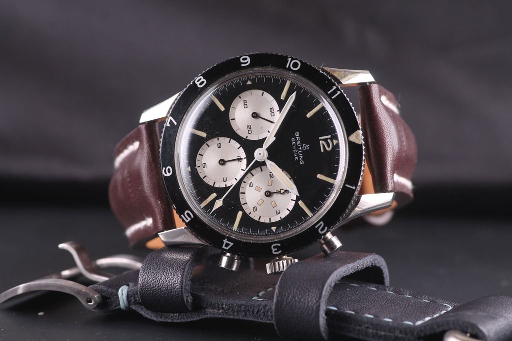

 Post subject: Re: AVI Advice?
PostPosted: Tue Jul 14, 2015 12:06 pm
original and untouched :
3 people like this post.

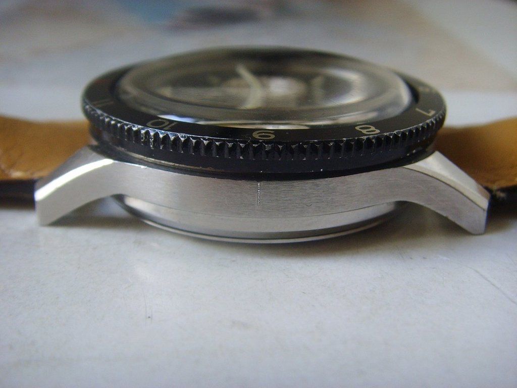

before we go saying its all correct etc
have a look at the bezel vs. case . Why doesnt it fit ?
PostPosted: Wed Jul 15, 2015 3:35 am
did not look at the profile pic, that truly needs to be answered.
can't be too small, as far as we know ?
PostPosted: Wed Jul 15, 2015 3:45 am
only explanation I can come up with is that it has a totally incorrect plexi that prevents the bezel to be pushed down and fitted correctly
have a look at the bezel vs. case. Why doesnt it fit ?
That was part of my question on this watch. Sorry that I was not clear enough the first time. :oops:
