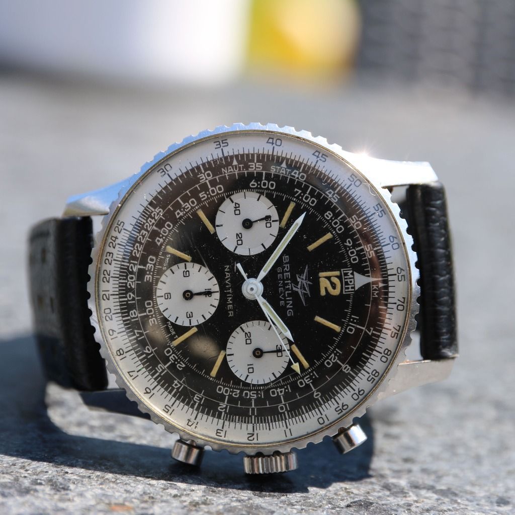

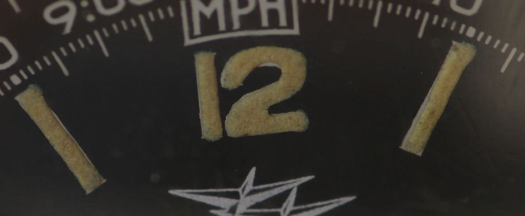

I have absolutely no reason to doubt this watch as I bought it from the original owner with papers
but it does show very sloppy lume , a very 'phat' '12' and a lumed chronotip

Interesting indeed.
I would have though it was relumed if you have not said it is not.
It looks odd, but it's definitely Tritium.
It looks like a lot of artificial light has been used in shooting the picture, and that makes the Trituim look better/different/more glossy, then it is for real.

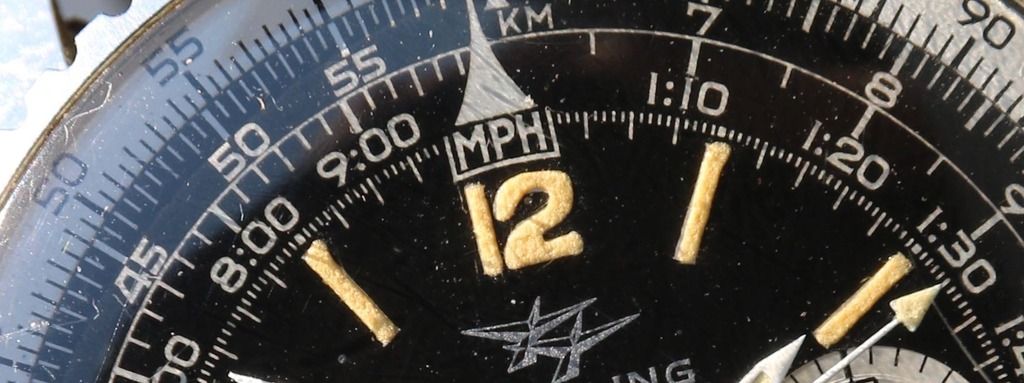

PostPosted: Thu Jun 11, 2015 1:22 pm
Hi Kurt
I shot pics in shade (3rd pic) full sunlight (1st and 4th pic) and with 2 studio flash pods (2nd pic) to show different angles , graininess of the lume , thickness of the lume etc. so thats why it maybe looks different colours under different light , but its really light still
its definitely tritium and I see no evidence on any of the hour marks , hands or '12' that 'old lume' was previously removed or lumed over old lume
absolutely no scratches on the dial around any of the hour markers that point toward old lume removal
After having studied the dial under a loupe for an hour or so I can only conclude its original , as sloppy as it is
and I agree , its very sloppy !

Dracha wrote:
Hi Kurt
I don't believe the Tritium has been redone, for the same reasons as yourself, it's probably just one of those dials that looks a little aside, and it is really just a little, nothing wrong with that at all, and it's a beautiful watch.
