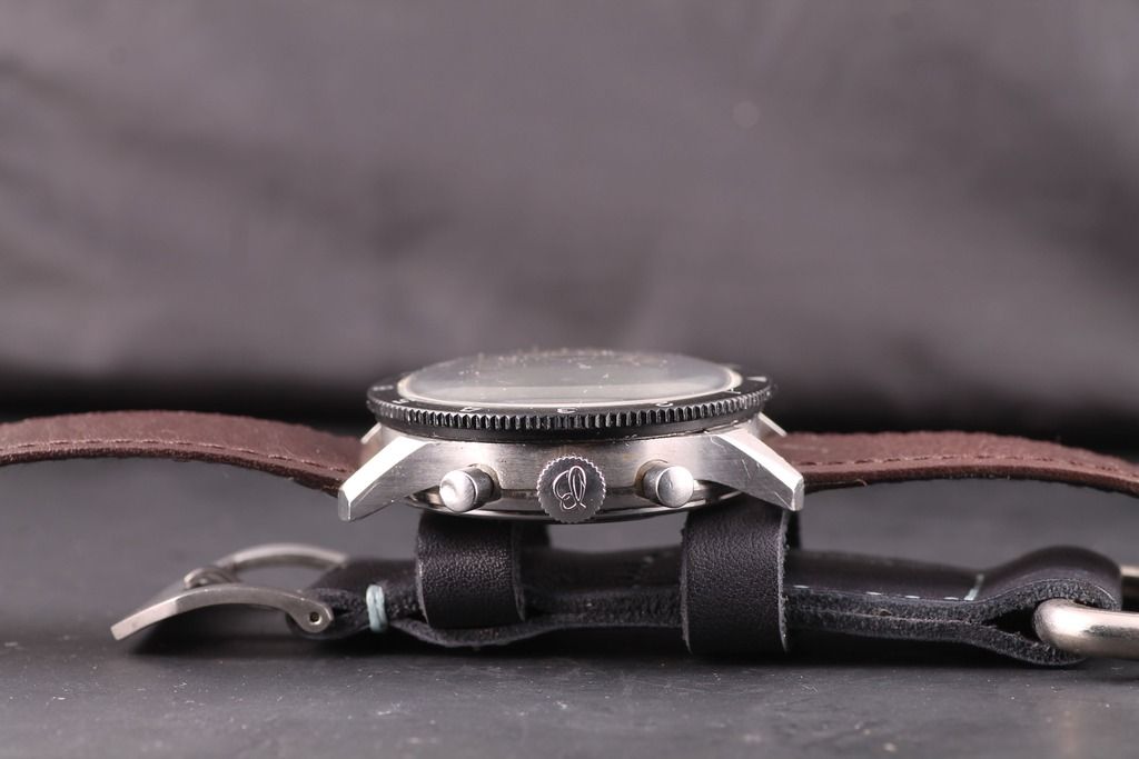

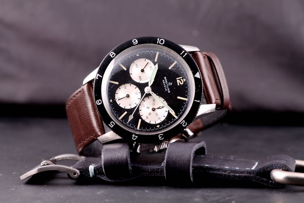

Had the opportunity to pickup this Co-Pilot. Did some research and found it confusing on determining the watch originality. the serial number dates it around 1969 but the case back and bezel installed look different than ones I've seen. Although there is a lot a variant in the types of case back and bezel installed on the AVI family. I found two references that gave me hope. Here it is.
 Post subject: Re: AVI/Co-Pilot
PostPosted: Tue Apr 28, 2015 12:46 pm

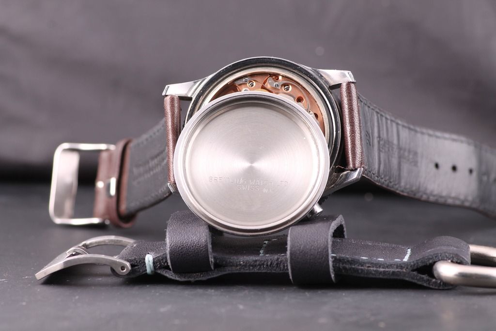

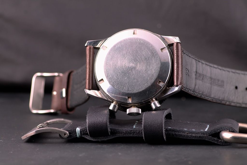

Can you please post more pics ? , backside and inside please , with a visible view of the engravings on the backside and (partial) serial number ?
1969 would be strange as that would be a 7650 , which is larger than the 765
Also the bezel looks 'off' (Fred ?, 3rd we've seen in a very short period)
afaik the metal bezel was used from 62 to 65 , the black aluminium bezel from 65 to later
also the 'normal' metal bezel had dashes '-' instead of odd numbers and only arabics for even numbers
p.s. can you move the hour hand for the next pic please ?, I would like to see the hand for the 15 minute counter subdial
Sure can,

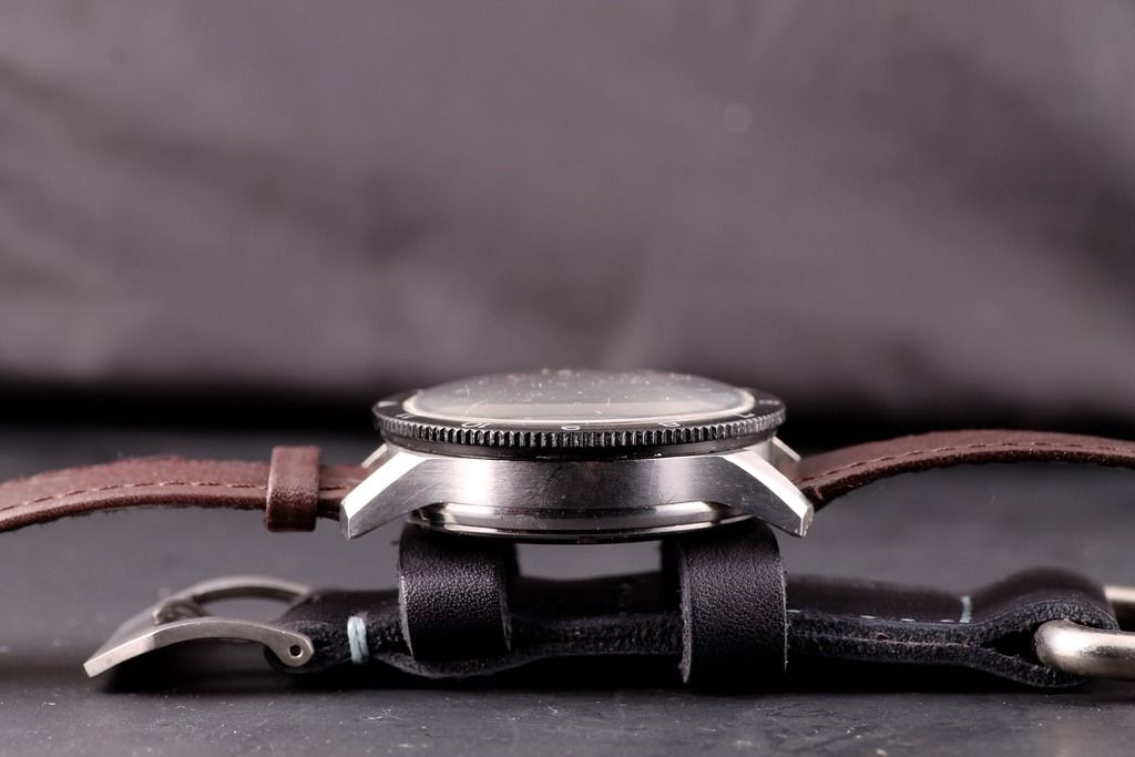

I noticed the differences between the other references. You are right in the case is larger and thicker than my Unitime 1765. Case is thicker and turned down lugs are all larger. It wears higher on the wrist, all with a 22mm strap.
The case back show ref’ 7650. There is no AVI or Co-Pilot designation. I found an old Wakmann catalog with this model reference as a “Co-Pilot.” It shows the same white sub-dials and full numbers steel bezel. The numbers on the bezel looks like on the other AVI reference. see the pic. The serial 1278xxx which my lookup dates it to 1969 time frame.
The dial looks pretty much like an AVI/CoPilot model. Sub-dial layout, 15 sec large right sub at 3 and familiar hands. I notice that the SWISS is at the bottom of the dial and the tritium “T” is under the “6” on the 12 hour sub-dial (something I’ve seen on the 1765).

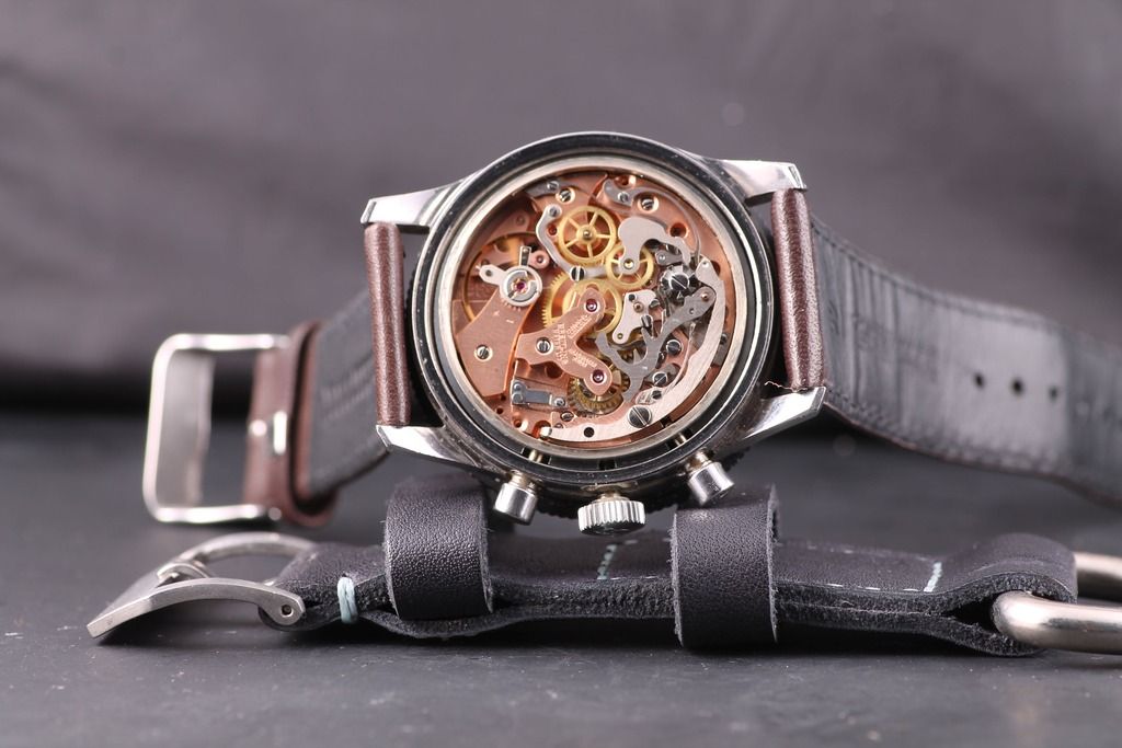

The movement looks like a Valjoux manual movement. It does shows the Wakmann's import branding.

not a Valjoux, but Venus 178, though WOG is wrong for a 1969, so this one had quite a bit of work done during the years.
not too easy, but correctable, the crystal is wrong and misses the chrome tension ring; also the running second hand is a replacement.

this is what I think :
-: its is a 7650 (no AVI or CP model denominator on the back, so 'just' 7650)
-: it has a service bezel (stainless steel) but originally was produced with a black aluminium bezel
-: the ad. you are showing above is from 1963 , or at least it is showing 1963 model watches (black white 809's and 806's with beaded bezels were made in 1963)
-: it is an original Breitling V178 movement but from an earlier watch (pre 67/68) as it has WOG , and original because it also has TJ , so not just the balance bridge was replaced
all in all extensive work was performed for whatever reason

Another difference in the 7650 case is that it is much taller. This makes the crown position sit lower down from the bezel. I compared it to your 7650 pictures and all is similar (case, dial, case back engravings, and markers) except the bezel of course.

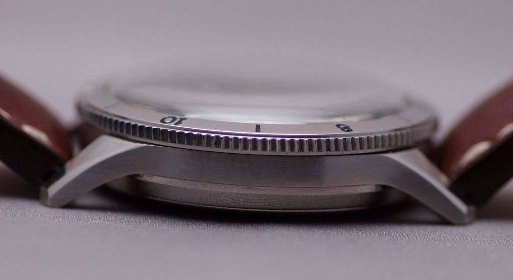

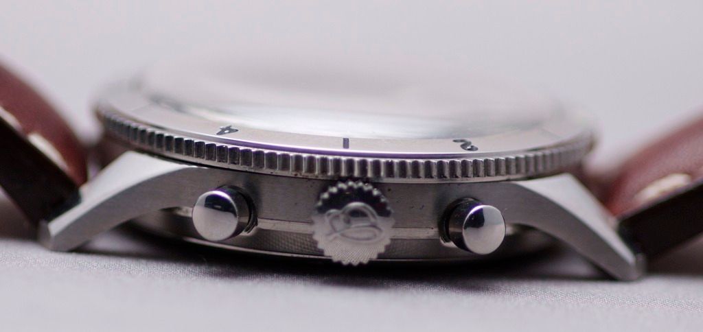

Would it be possible for you to post a close up side view and a picture of the 765 metal bezel?
PostPosted: Wed Apr 29, 2015 11:15 pm
PostPosted: Thu Apr 30, 2015 12:04 am
the assumed service bezel is sitting incorrectly.
note that the 1765 existed (think Rene is off the fence too regarding this) in both 765 AVI/CP & 7650 sizes.
1953 case, 765 AVI: case dia 39.95, bezel dia 41.05, height@bezel 11.25
1963 case, 765 AVI: case dia 40.10, bezel dia 40.95, height@bezel 11.50
1965 case, 765 CP: case dia 40.20, bezel dia 41.00, height@bezel 11.50
1969 case, 7650: case dia 40.80, bezel dia 42.85, height@bezel 13.45
1969 case, 1765: case dia 40.70, bezel dia 42.55, height@bezel 13.45
1975 case, 7656: case dia 40.80, bezel dia 42.65, height@bezel 12.90

Thanks again Fred for the measurements. My 7650 case diameter is 40.12 mm, bezel diameter 41.17 mm, couldn’t get a good measurement bezel height. I don’t think the caliber I have is very good. .
In comparison to Rene’s bezel pic, my has a similar structure as the one pictured, numbers engravings, coin bezel and properties of the smaller version. Bezel does look the part that Breitling would make for their CP model. Will eventually get the crystal and sec’ hand replaced, maybe then I can get better pictures and more info.
