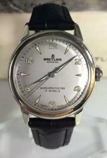

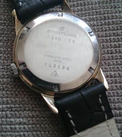

Hi, a friend of mine is offered this three hands Breitling with ref.number 2910 29.
I think it looks like a redail, and i do not like that ref.number. We have seen that on a lot of China-fakes on Ebay.
Seller insist it's real and worth USD 1.700.00 because the local watchmaker says so....
I think it's worth USD 2-300 if it's real.
What du you experts think?
Regards
Jarl
http://www.classicheuers.blogspot.com
PostPosted: Tue Mar 31, 2015 2:28 am
case might be real , dial is repainted IMO
value ? , 2,3 maybe 400 max *IF* its all original
