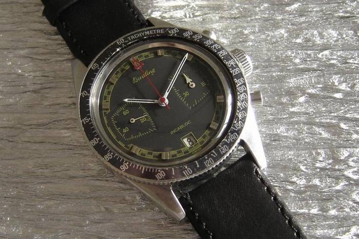

Dear fanatics,
We're able to acquire a vintage Breitling 94112 with 7734 valjoux from 1964.
There's hardly any information on the net, only the museum, there is one picture.
Do you have any knowledge about it?
Kind regards,
VTGwatch

There is no such model as far as I am aware. If its the one on breitling museum I think its a fake.

your member name implies you are a professional seller of vintage watches, so you might be interested to hear that the Valjoux R7734 was introduced in 1969 - how did it end up in a 1964 Breitling. Note that the majority of the vintage pieces on that "Museum" site are franken or outright fake.

Post some pictures for a real assessment. But.... It does NOT look good.

Dear all,
Thanks for all the info, we will not go ahead with it.
Regards
PostPosted: Mon Feb 16, 2015 9:56 am
funny
its horrible really

I've seen that 3 and 9 subdial shape on a South American Ebay special recently.
