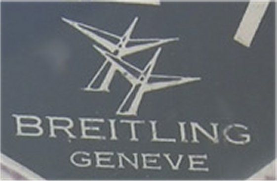

I noticed this photo recently... Upon a glance I thought perhaps it was a Top Time dial placed in an 806... But upon closer inspection it appears to be a small-subdial Navitimer dial. I've asked WatchesbySJX for more info, but have not yet gotten a response. He says it belongs to a Navitimer lover from Switzerland.
Is this old news? I searched the forum but could not find anything similar.

there is no documented "Albino" Navitimer 806 - the only example we've seen was a "prototype" offered by TheSage Michael März of youknowhatlounge and on larger pictures it was clearly identifiable as a Frankenfake; this pic is too small to say anything relevant.

Thanks Fred. I'm intrigued by this photo because the other pieces appear to be correct. I am very curious to see more photos, but would not be surprised to learn it was homemade.
Will try to get more pics.

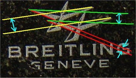

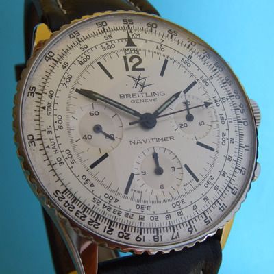

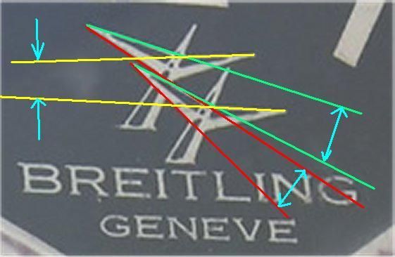

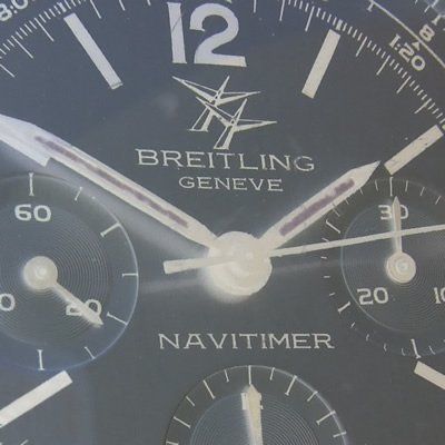

here's the watch
lets make a negative for easy comparison
lets zoom in on what matters
now a genuine dial
fake
real
convinced ?
I am 8)

Rene's trick is also a useful way to distinguish between original and service dials. Not so extreme, but same idea. That was one of the first pearls of knowledge I remember absorbing from this forum.
