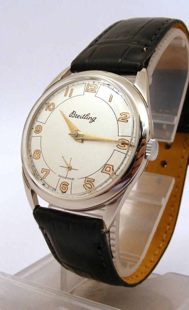

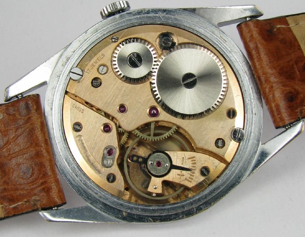

this one started its life as something else as the original markings have been grounded away

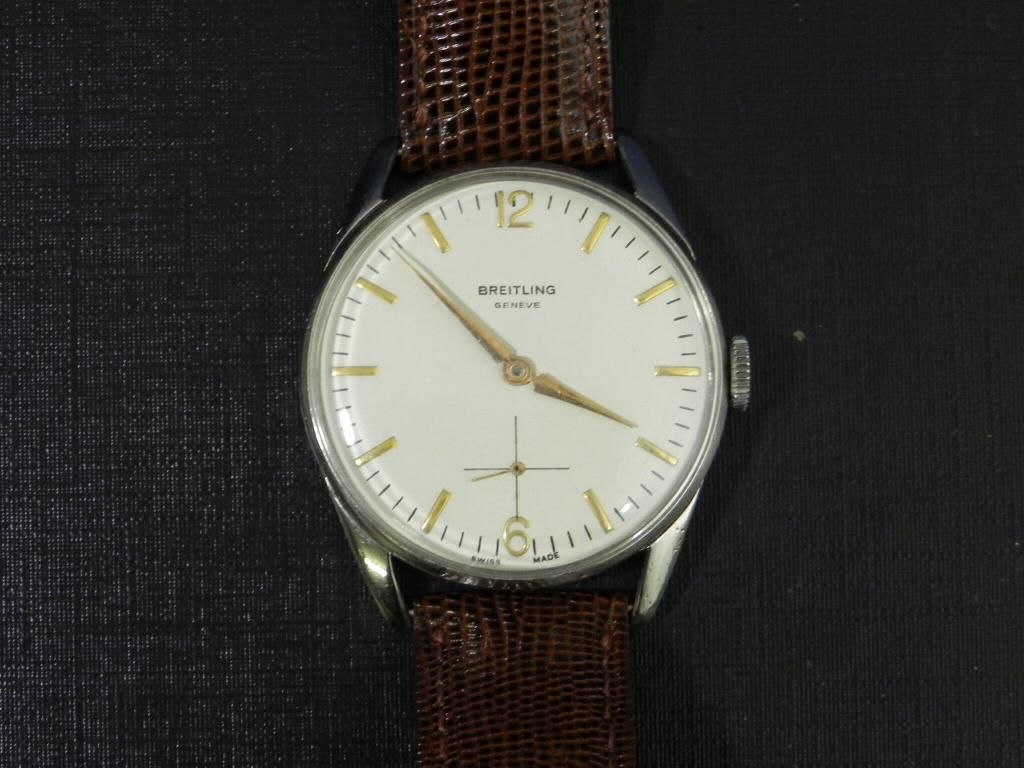

this one has sloppy dial refinishing (painted over the 6)
sloppy dial refinishing , where the last S of swiss is hit with paint
maybe I am just paranoid ? ;)
PostPosted: Mon Nov 17, 2014 8:27 am
Joined: Fri Oct 31, 2014 7:54 am
Posts: 13
Scratched serial numbers are never a good sign in a movement, and guns :P Also on the 2nd picture the 12 is placed right on the markers and the "made" of Swiss made is crooked and a lot closer to the markers then "Swiss".
