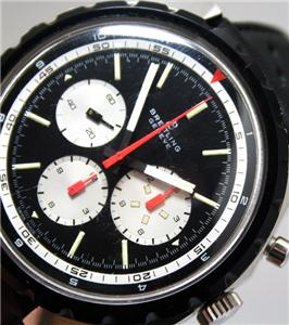

Hi, I am new here and not experienced with posting in forums. So forgive me if my postings are strange from a technical standpoint. I recently purchased an AVI 765, but I am struggling with finding out if all component are matching. I think movement, case and dial are matching but how about the bezel. If anybody could help me with that I would be happy.

PostPosted: Wed Feb 12, 2014 1:28 am
well, Renè/Dracha, Mr. AVI, will chime in soon, he knows all there is to know about these pieces.
watch looks basically correct for a 1965 AVI ref. 765, running seconds hand is wrong; minute counter is hidden but seems the right shape, though looks a bit too long - if u "unhide" it and repost we'll be able to say more; bezels is in exceptional condition, dial seems very nice; congratulations !

the 1965 AVI has been seen with black bezels as well . However the hands are incorrect , as Fred already stated the running second hand is incorrect (subdial) but also the dial looks to be an incorrect replacement , there's no '12' at the top ?
furthermore
Chrono hand slightly too short
15 minute counter (subdial) hand incorrect
Minute hand looks slightly too short but I cant really tell from this pic
and I believe the hour totalizer is incorrect as well
given the original hands are probably impossible to find, all in all the restorer / watchmaker has done the best he/she could finding replacements , I like the replacement (arrow shaped) Chrono hand and would love to know where they got it from
PostPosted: Wed Feb 12, 2014 2:20 am
Dial is (the same as) from a ref 7652, I think someone used one of those as a replacement dial

Thanks for your quick expert replies. Looks to my like I bought a part bin exercise. I will send more pics with unhidden hands. The watch looked like a hardly worn nearly nos example, but with all the changes it's more likely a resto.

IMO not even a restoration but more , as you stated, a parts bin watch. Now known as a "frankenwatch" which is a watch build together from parts from different watches.
It is wearable but not original and not worth as much as a 100% correct piece

here are some more pics, dial does not really look similar to 7652. What would you think, how much a "frankenwatch" could be worth?

Doc-Joe-Black wrote:
here are some more pics, dial does not really look similar to 7652.?
Please have a close look at both dials , they are identical
May e the coloured hands and ring around the dial throws you off but it really is a 7652 dial in your watch , an original 765 AVI dial has an arabic 12 at 12

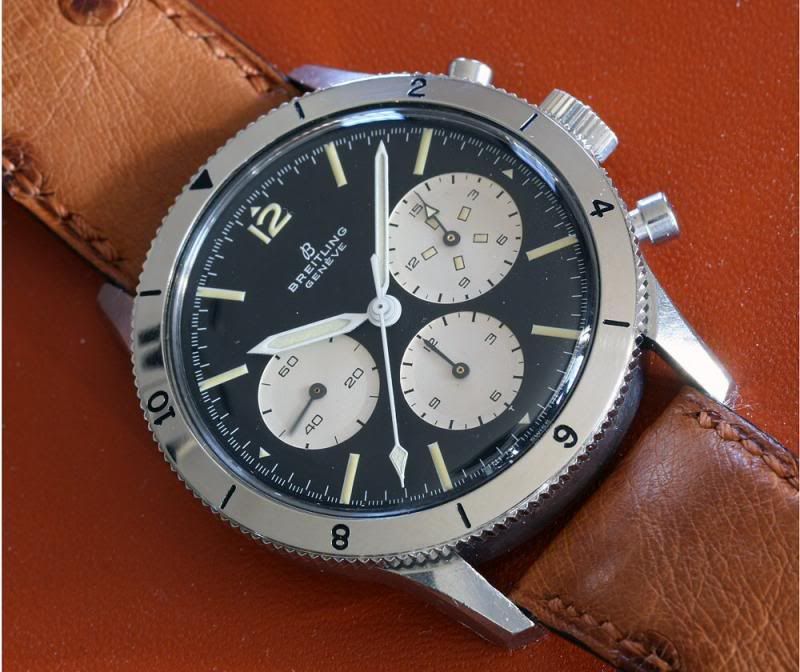

Here is an original dial
