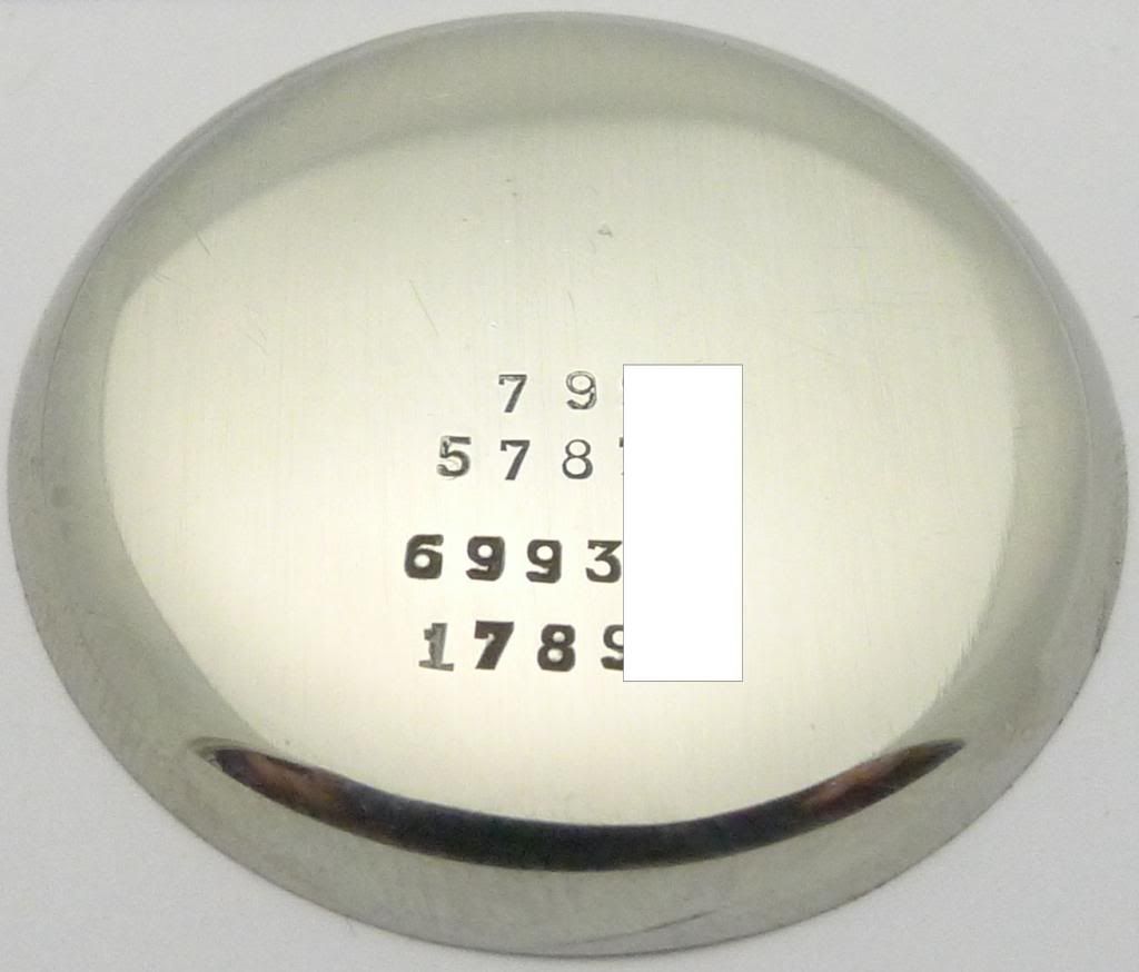

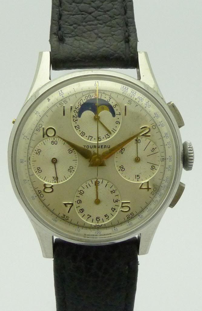

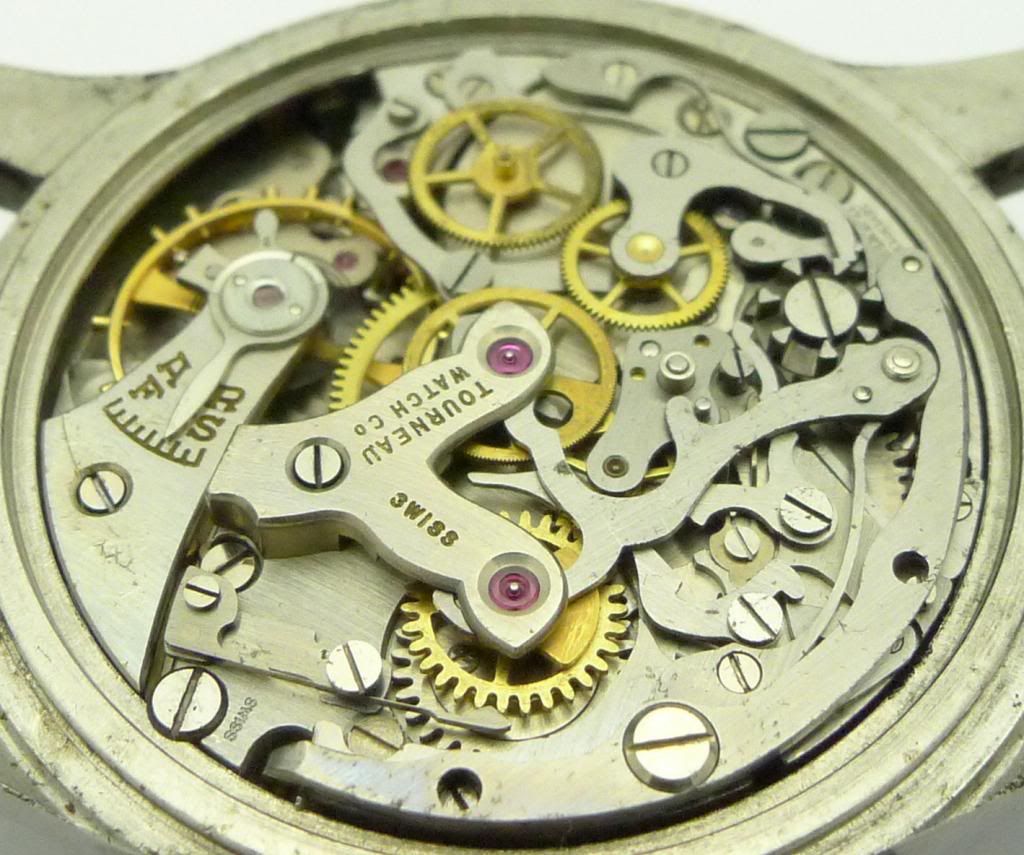

here also a 100 % genuine Breitling Datora 799 with all original Breitling serial- and reference numbers, but signed with "Tourneau"
http://www.ebay.de/itm/TOURNEAU-CHRONOG ... 35c51954c4
 Post subject: Re: A Singer Chronomat?
PostPosted: Fri Aug 09, 2013 7:02 am
and with a non breitling (TXY?) US importcode, how can you say its a Breitling ?
It does however raise some questions , are these Tourneau's used to build Breitling Datora fakes ?
now that we have seen this one, should we question all Datora's with these 4 lines of numbers on the back ?
or is consensus still that those are OK with 4 lines of numbers on the back and this tourneau was built by Breitling for Tourneau even though there's no indication ?

pondering that tourneau '799' still and tossing some ideas around
Why , if this was made by breitling, would breitling put TXY on their 'OEM' watches they make for tourneau and mark the bridge with 'tourneau' but would not mark their own watches with BOW/WOG and use unmarked bridges ?
that doesnt make sense
if tourneau was obligated to put their US import code on the watch , so would breitling . Also I can imagine breitling having a much larger number of '799' 's sold worldwide so they would definitely have the US import code on their watches ?
taking it one step further still assuming the tourneau and breitling came out of the same factory , would they be made by an OEM like venus/valjoux and sold as 'blanks' to whom ever wanted them ?
Tourneau , as one of the very big US watch retailers during the post WW2 period, was enough powerful to get branded watches, mabe from Breitling and probably from other watch factories .
Nowadays, big retailers like Wempe are distributing "exclusive" models with double branding .
In many segments, the branding policy is generalised and many products are personalised at very last step. It is true for cars, washingmachines , etc , and there are many examples of retailer brands .
On this watch, no Breitling marking so there is no legitimity to call it Datora 799 in any way . It is exactly the same story than the Wakmann triple calendar , which have been abusively renamed - by the Sage - as " Wakmann- Gigandet - Breitling Datora , with prices x 5 .
My opinion for this watch, but it is only my humble opinion, is based on the fact that before 1981 the swiss law about intellectual and industrial property was very laxist . 50 or 60 years ago, the business rules were the same , and it was just business . As Breitling was buying cases from a subcontractor , the subcontractor had an industrial right on cases , and he was free to sell similar cases to other customers . It was easy for a company like Tourneau to pay royalties to Breitling and get a swiss clone of Datora 799 directly from a swiss assembly factory , buying Tourneau branded parts from the same subcontractors used by Breitling ... In one hand it is just a classical way to do business , and in the other hand , consider that regarding the law of this period, it was not a problem .
My concern is : no Breitling sign but double number - Breitling type and SN + Tourneau type and SN : why? Maybe for asseting royalties?
PostPosted: Fri Aug 09, 2013 8:29 am
Agree absolutely, we know that this is a relatively common design of the era and no reason to believe that it is Breitling sourced vs. any of the others (or indeed from parts suppliers). Any suggestion of a Breitling connection is simply an attempt to inflate value.
